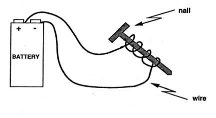

You are able to get contact to the set screw with a small thin object and touch it, so how about build a cheap electromagnet?
Use some strong insulated wire and at one end attach two wires which go to the +/- of a battery?
Sort of like what we used to do in science class way back when :-)
http://986forum.com/forums/uploads01...1422037098.jpg

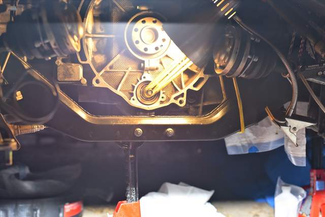

Don't give up yet, you might be on the one yard line! The fastener is in the "U" shaped channel in the lower right hand corner of this picture. Use a strong magnet from outside the block to drag the fastener up the ramp out of the channel. This would be dragging "into" and "up" for this picture. Once dragged up the ramp it's no longer in the channel and you might be able to see it with your endoscope. Pull it towards the center of the engine. If it drops from there you can grab it again through the aluminum with magnets from inside the oil reservoir area, in fact having magnets taped to the area you want the fastener to go might be a good move. Then drag it up to the large hole under the cylinders and into your hand. When you get this bolt out you need a vanity plate that says "986FISH".
http://986forum.com/forums/uploads01...1421959747.jpg
I'm going to attempt the strategy above and report back. New magnets arrived last night. I should be able to demagnetize the IMS bearing at least if I end up accidentally magnetizing it.
Dropping the engine out sounds like a recipe for even greater calamity/expense/fun, so I'm holding off on that until need be.
