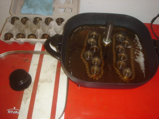

You can clean & test the lifters by submerging in new clean oil & heating to 250 degrees. Keep them in order so they can be returned to their mating cam lobe if good. Once up to temp compress the plunger & watch for dirty squirts coming out the side until it's cleaned out. If it won't pump up firm, replace it.

I used an electronic stethoscope the noise was coming from the intake side of cylinder 4. Also where I found the tappets that do not pop back they are compress continuously at least while cold. I did notice that once the engine was hot the sound became less noticeable so I plan to steel my wife's electric fry pan and do the hot cleaning suggested. I may still replace them all anyway.
