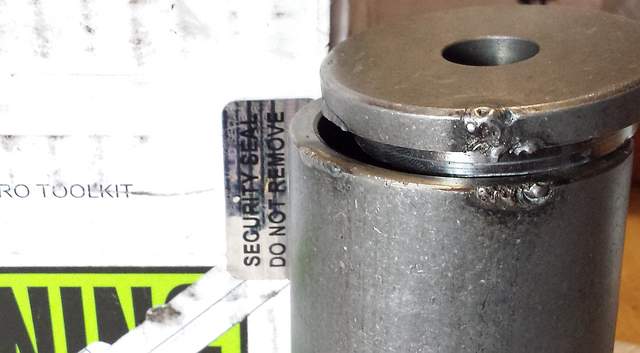

I used my IMS tool: "LN Engineering Engine Intermediate Shaft Bearing Tool Set 1060813" that I purchased on Amazon. I tried a few wrong ways first, then managed to successfully extract the bearing from my 'practice engine' and reinstall it.
I am wondering if my tool kit is actually a counterfeit. The box was sealed and had all of the correct labeling, but my cat can do better welds.
http://986forum.com/forums/uploads01...1415047446.jpg
I'd have my cat repair it, but even with the welds broken, it worked fine.
I suppose that to a counterfeiter it actually is just $20 in metal chunks.

This part of the puller has no load during extraction, in fact, the load holds these pieces together.. How did it break?
It may not be real, hard to say, most everything we've done has been ripped off at this point. I just had to file another Patent application today.

It was actually after the extraction that the weld broke. The bearing was jammed in the end of the tube by the remnants of the dual-bearing locking ring. I gave it a couple whacks with the handle of a 1/2" ratchet. The bearing came out one end and the end came off the other.
Even with that glitch, the tools worked well despite my slight variations from the correct procedure.
