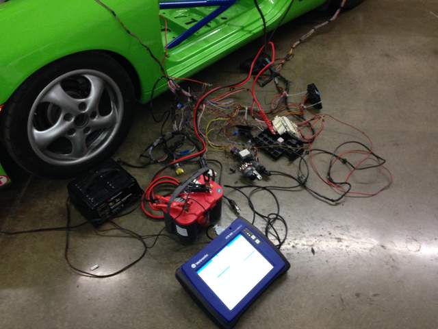

Brad Roberts 08-07-2014 10:29 AM
Here you go.. I test the harness before it goes back into the cars (and before we wrap it with the factory cloth tape.
