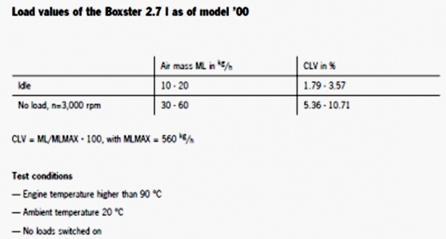

What are the specs for the MAF at idle and ~2000rpm no load in g/sec?
I have a feeling my readings are VERY low

jb92563 05-14-2014 09:29 AM
Not the right engine but I think its the same MAF.
http://986forum.com/forums/uploads01/maf1400084941.jpg
