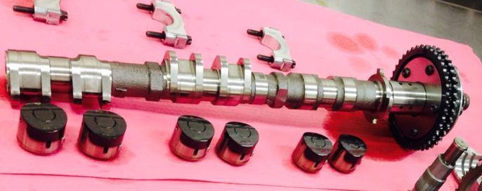

Jager 10-28-2013 08:00 PM
Originally Posted by Jake Raby (Post 369762)
I am a little busy at the moment... Creating another DFI Beast. While other people have just started developing M96 components and entering the market we are on our fourth year of DFI engine development at the next level.
Interesting lobes on that cam...
http://986forum.com/forums/uploads01...1383015629.jpg
