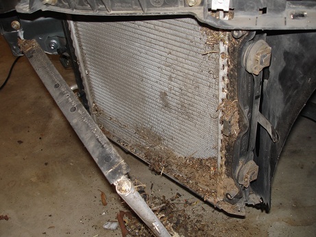

Jager 06-26-2013 07:55 PM
Depends on what part of the planet you live on as to how often you need to clean the radiators, but eventually they do need to be cleaned.
Here is what mine looked after I finally got around to cleaning them.
http://986forum.com/forums/uploads01...1372301722.jpg
moresquirt 06-27-2013 04:10 PM
Thats really bad,definately some rot and cooling issues there,not sure the history of my car prior to 70000 kilometers so i am going to pull the bumper at end off this season before storage and see whats going on or in there.
