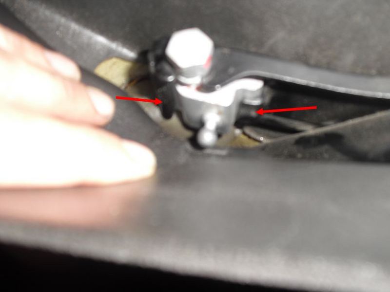

Meir 10-11-2012 11:28 AM
looked again at my car, and it looks like the aluminum plate, is held in place by two metal "ears" (sorry for the bad pic)
http://986forum.com/forums/uploads01...1349980061.jpg
see if you can bend them inward somehow, to put more pressure on the plate.
