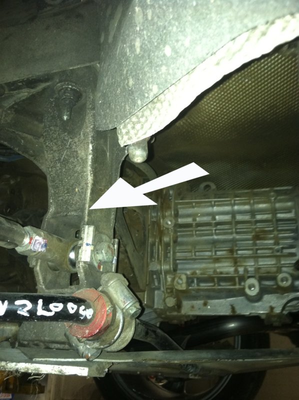

I just finished my IMS/RMS/Clutch/Oil file tube/AOS and am putting things back together. A year ago when I did my transmission fluid I noticed the support panel (see pic) was not easy to get back on. The car has been on jack stands for 10 days and I'm sure stuff has moved a bit, the panel is even harder if not impossible to get back on this time. Instead of forcing it I figured I'd ask for suggestions. Do I need to lift the rear suspension a little or something else....any ideas would be great!

WOW nice shine, what I do is take one of those "smaller" ratchet straps, tie it on to the suspension and tighten it up (pulling the suspension back together) until the panel goes back on. works well. just need to find a location so you don't pinch it.

take the strap and wrap it around the area near the rear anti-roll bar mounts..

Brad Roberts 01-04-2012 08:50 PM
Did you set the car down on the ground with the pan off? :(
Wrap a strap around here on this side and go all the way over to the other side... ratchet the two together until the studs line up on both sides.. release the ratchet strap when you have things lined up and nuts started.

You do know.. you should have the car re-aligned? correct? or at least checked? you are changing toe and camber as those suspension carriers move out/in without the panel in place. It is nearly impossible to get it back to exactly the right location.

Brad Roberts 01-04-2012 09:05 PM
I leave the 4 bolts loose on the black cross member before I install ANY of the lower pan bolts/nuts :) This allows everything to *float* making aligning the nuts/bolts a cakewalk!!

It's the black bar that connects the suspension uprights together, and the front of that pan bolts to it, IIRC. I hope to be putting that back together on mine this weekend after 4 months apart.

No no, you can take it on or off as long as you don't loosen or move the cross member. If you can't get it back on with a similar effort as when taken off something has moved.
If you drop the car or drive around with it off all bet are off on you alignment spec.

WhipE350 01-05-2012 10:51 PM
I would find a good Indy that has the proper equipment and knows Porsches...just my view though. I had mine done by one, it was somewhat expensive (I think around $180) but they worked on it a long time and it really made a big difference. I had moved things pretty bad putting in my new shocks.
Oh and everything is now back together on mine. I improvised with some straps and everything went on fine
