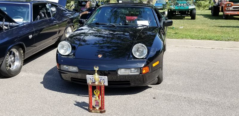

husker boxster 07-03-2025 04:03 PM
Was out enjoying some car shows last w/e - 3 in 2 days. While at the Sun event and some time to kill, made a list of things left to do and buy. All minor items on both lists.
Brought home some hardware.
http://986forum.com/forums/uploads02...1751583712.jpg
