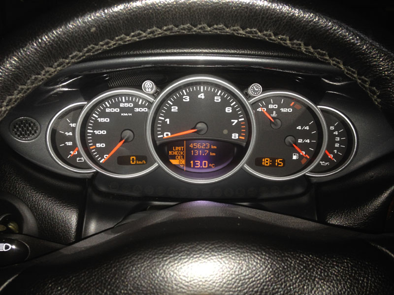

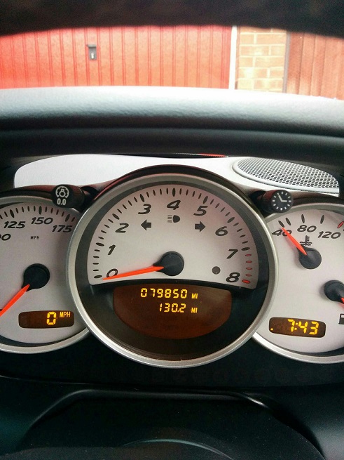

jpc763 01-20-2016 03:36 PM
2 Attachment(s)
So, what is involved with moving from this
Attachment 20043
to this
Attachment 20042
Do the side dials work (oil pressure and current)?
Thanks, John
particlewave 01-20-2016 03:54 PM
John: the 5 dial clusters are from the 996 and are interchangeable with 986 clusters with some minor work. Search for "Carrera gauge swap". ;)
