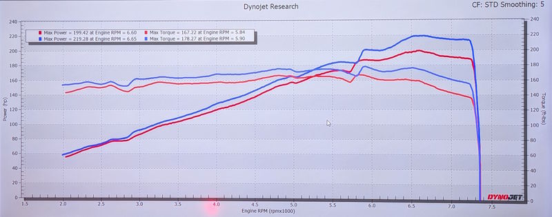

Getting back to the original thread topic, I dyno tested my car yesterday. To recap my setup I have the following:
Intake side:
- 987 airbox
- 987 BMC filter
- 987 intake tube and MAF
- 45 degree elbow
- 997 throttle body (74mm I think?)
- 987 modified distribution tube
- 996 plenum and runners
Exhaust side:
- 996 equal length headers
- 2 inch stainless tubes
- 2 inch high flow cats
- 2 inch valved mufflers
Other mods:
- AC delete
- Electric PS conversion
- Underdrive pulley
For tuning I am using an ApexI SAFC. AT WOT, my AFR is around 11:1 (logged with an AEM wideband), so I need to adjust that, but it's better to be rich than lean.
Here is the chart, blue is mufflers fully open, red is mufflers fully closed. I should have done a 'partial open run', but I didn't.
I'm pretty happy with the results, I'm basically at crank power, to the wheels. Without doing a lot more very invasive mods, aside from tuning the AFR, I don't think there is much more I can get out of this thing.
