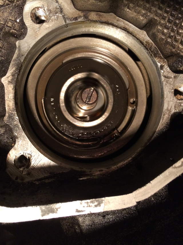

Viper10000 01-29-2015 12:57 PM
So I had some time to remove the flywheel and pressure plate today. Looks like the RMS is not leaking but the IMS flange is. I'll try to dig further when I can.

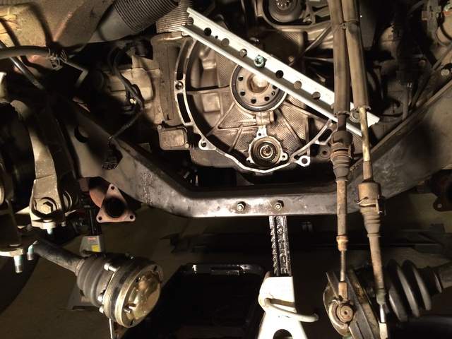

Well I got a little further today. I got the cam locked, oil drained, tensioners removed, and the IMS flange removed. So far the bearing looks great. I can not feel any play in the bolt and it spins rather nicely. I almost don't want to remove it but since it is a single row with 138,000 miles on it, I will be pulling it out. Here is where I am at...
http://986forum.com/forums/uploads01...1423175350.jpg
http://986forum.com/forums/uploads01...1423175376.jpg
I'll be pulling the bearing when I get more time. I'm just chipping away at this project little by little. I will flush the tensioners in fresh oil before I re-install. Thank you all who responded. I will also try cranking the engine to build oil pressure in them as well after it is all back together.

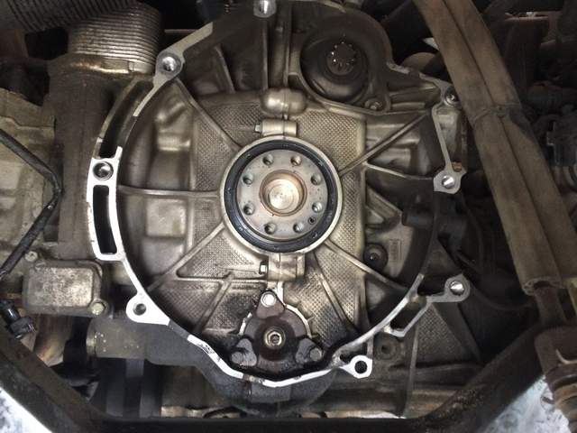

Viper10000 02-13-2015 07:26 AM
So I've made a little progress. Flange on and all torqued to spec. There was no room on the bearing stud for green loctite but I put a little Curil t at the end for some extra sealing. Next step is chain tensioners and checking the timing.
