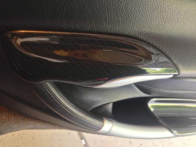

kiyakubuke 05-25-2014 07:02 PM

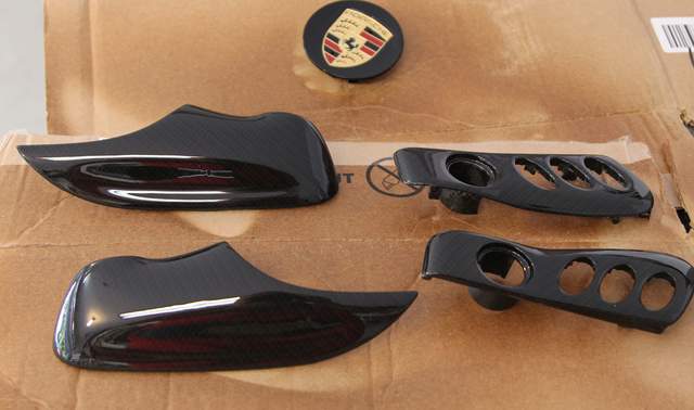

carbon fiber trim pieces
finished hydro-dipping the door trim pieces. now to do the center console. I went with black on black for a more subtle look. I thought the silver on black etc.. looked too intense. I also played around with the car color (guards red) as the base color. I could see that would look good, just not for me. although, I am tempted to do that for the small piece on the shifter.
http://986forum.com/forums/uploads01...1401071268.jpg
so glossy it is hard to get a good pic.
http://986forum.com/forums/uploads01...1401071315.jpg
full resolution pics.
https://www.flickr.com/photos/darrenkitchens/sets/72157643119982073/

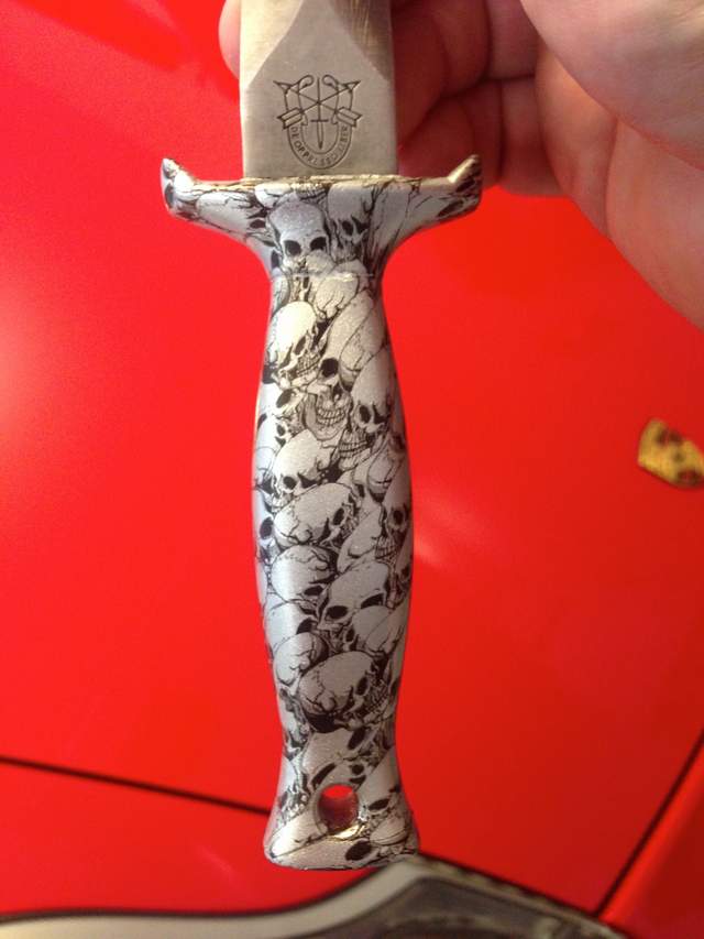

not really Porsche related, but, when I bought the carbon fiber hydro graphics film, they sent a few samples of their other films. had an old knife that was looking rough, so I thought I would try it out. don't worry. I would never put skulls on the boxster :)
http://986forum.com/forums/uploads01...1401667660.jpg

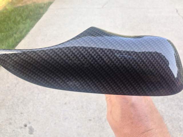

haven't started on the center console yet, but I wasn't happy with the clear coat on the smaller trim pieces I practiced on, it was rattle can "automotive" enamel. so I went to the local auto paint supply shop and got some high solids acrylic urethane. much better results. not only looks better, but hard as glass as well.
http://986forum.com/forums/uploads01...1403206350.jpg
close up of the door handle trim:
http://986forum.com/forums/uploads01...1403206380.jpg
has to dry for 16 hours before I can buff it.

high res version:

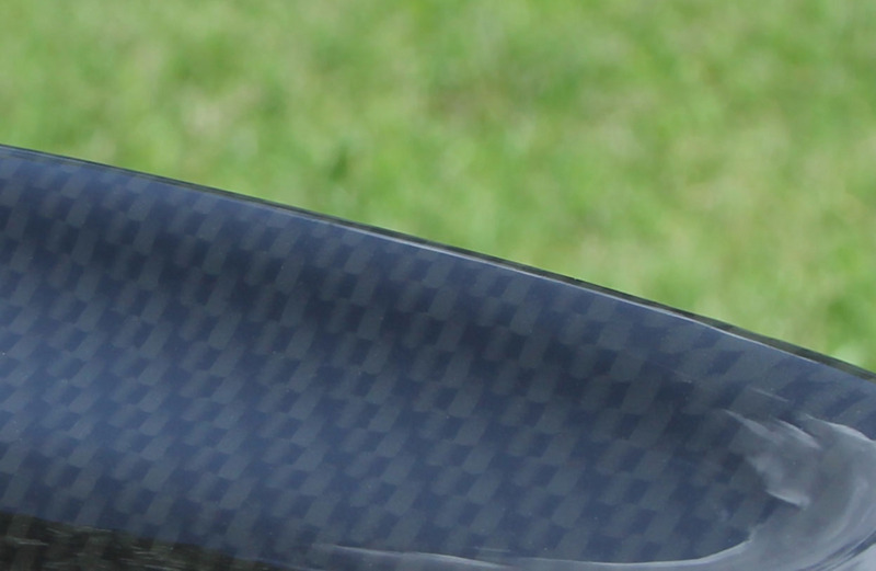

so I've redone these things about 4 times, kept messing up on the clear coat. clear coat was a High-solids urethane I had gotten at a local auto paint supply shop. ran through the first quart I had gotten and went back to the store. mentioned to the guy the issues I was having. he says, it sounds like your pressure is too high. I had it set to the specs it said on the paint companies web site for an HVLP gun. so we looked and and the specs on their site were wrong. I had been shooting about 3X the pressure I should have been.
I'm sure that any paint pro would have know this at first site, but an amateur like me, I just went with what it said.
in any case, last redo with the proper settings looks great.
http://986forum.com/forums/uploads01...1407193782.jpg
