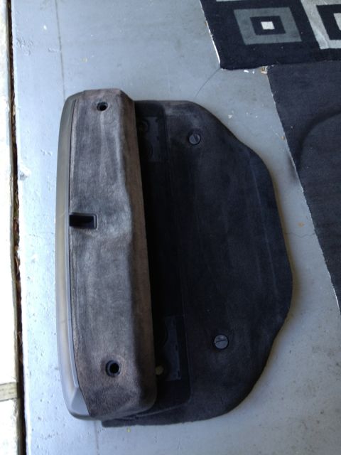

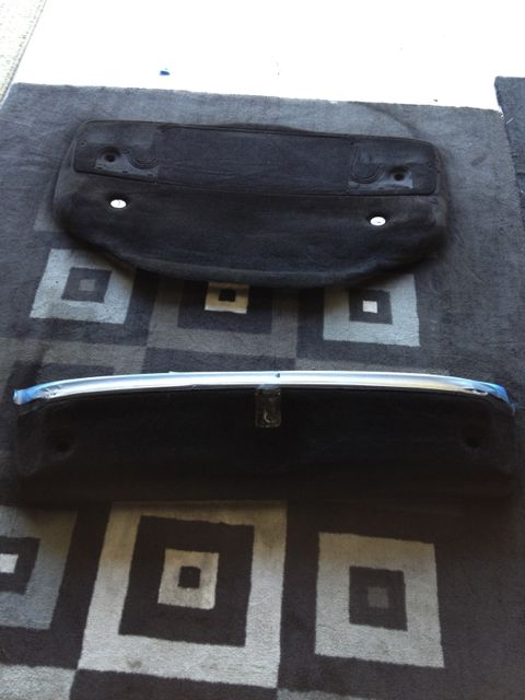

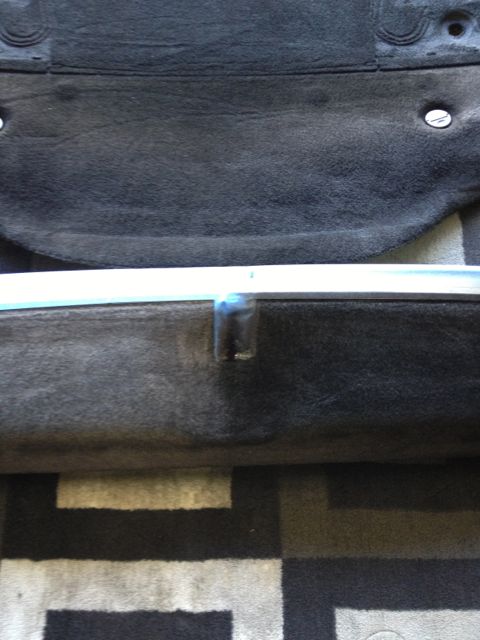

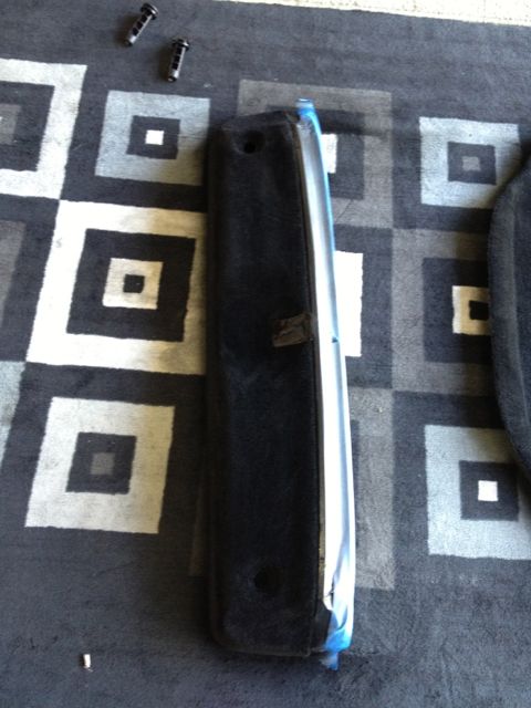

Thought I share some pic's of my faded engine cover carpet.
I have black engine cover carpet that was faded from the sun.
It had turned silver from the exposure. Brushing the carpet with you hand would produce fine silver carpet dust particles..
Vacuumed it well before painting.
I used Dupli-Color Vinyl & Fabric paint to fix my faded carpet. (AutoZone)
See pic's
T
Before
Attachment 16723Attachment 16724
After
Attachment 16725Attachment 16726
Service Position..
Attachment 16727

Bala: Did the same. But the carpets are not soft like before. I combed them with a nice plastic brush. Seem better now.
Yes the carpet is stiffer after the paint dried, I did the same as Bala.
My goal was just to get it back to Black.. That faded silver did match the car color somewhat, but looked bad..
I'm happy with the results..
T
