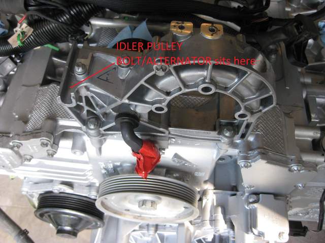

pjq 10-21-2014 09:15 AM
2004S
Hopefully these pic's will shed some light on what your dealing with. I don't have a photo of the alternator and its bushing your trying to free.
I remember even when I had the engine in front of me on a stand, the alternator was a pain to remove, it did come free.
http://986forum.com/forums/uploads01...1413907806.jpg
http://986forum.com/forums/uploads01...1413907840.jpg
http://986forum.com/forums/uploads01...1413907876.jpg
