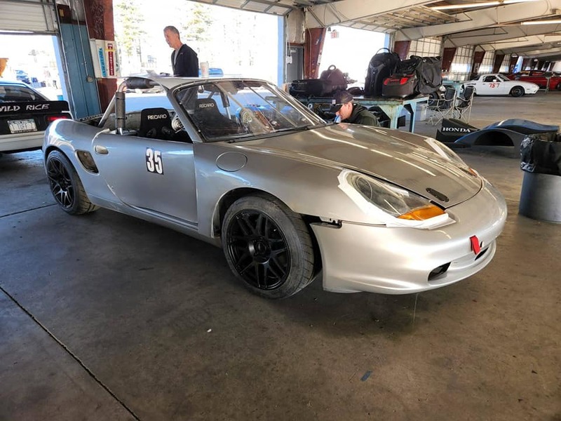

We did our shake down run at Chin HPDE at WGI
Overall it went well.
Best laps time is 2:20 We were targeting 2:12 so we have some work to do.
Compared to our 3.0L 944 the Boxster corner speed is similar but just not getting straightaway speed of the 944
We were on RS4 - 255 square.
May need wider stickier tires. But must run a 200 tread ware tire.
Water temps were good
Max engine oil temp was 230
Max trans oil temp was 215-230
The tiptronics was not horrible. We chose to let it upshift and we manually selected the downshift.
Overall I'm pleased but concerned about finding at least another 5 to 7 seconds

ike84 05-12-2022 06:43 PM
I think you will run faster on straightaways with a staggered setup, 225 or 245 (at most up front)
The only other thing you can do to help is the intake, which sounds like you're pretty much stuck with. I would find any way possible within your rules to make modifications here. Even if not adding parts, "substituting" the existing layout with larger diameter components. I really think 82mm is a magic number here, from TB to MAF housing to airbox. This will need a 996 tune to with but it will help (I'm so sure that I'll bet $ on it)
Sent from my SM-G970U1 using Tapatalk
ike84 05-12-2022 06:47 PM
Also, do you run with the top like that? If so, you may want to try adding vortex generators in different positions and seeing if that helps. You're gonna have a really dirty breakaway on the back of that roof which can show you down considerably in straightaways.
Just for my own curiosity's sake, what did you do with the windshield? Did you completely remove the OEM A pillar?
Endurance Racer 05-14-2022 02:48 PM
ike84 thanks for the input. The windshield is replaced with polycarb and the "A" pillars are cut away for the most part. I left only the body sheet metal for the poly carb windshield and half the A pillar support.
And yes the top is just an Alum sheet. The air all around the the cage and everything is going to very dirty.
