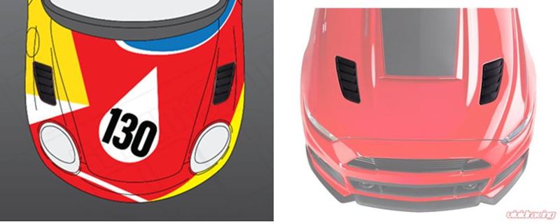

Here's what I'm thinking, the Rough Mustang vents are flexible, effective and cheap. Apparently the best position is at the top of the wheel well where air pressure is the highest (the tire pulls air up the back as it spins and the incoming from the ducts and rad meets it at the top of the tire.
http://986forum.com/forums/uploads02...1527708527.jpg
problem is that the top of our fenders is curved, so tough to find anything that would match that curve properly. that's why i like the first pic i posted - just several slashes across the fender, then bend them down.

truegearhead 05-31-2018 03:49 AM
Ya I agree, the problem is not skilled enough to cut and bend the fenders and make it look right without rewraping or repainting both fenders. I’m thinking the aluminum or ABS panels would take the fender shape with a enough rivets
The Radium King 05-31-2018 08:30 AM
i'd thought about that but it's a significant bend and my fear was the the louvers would distort (and not look cool). i don't live close enough to anywhere to actually get my hands on one to see. there was a company making a cf product for the gt2 that is nla. hey, you can always chumpcar it and get the deed done with a hole saw. otherwise, check the aero - from what i'd read, the highest pressure area is actually just in front of the wheel centreline.
