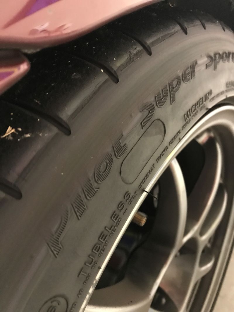

@jakeru very helpful thank you! Mine were installed "out of the box" with no adjustment, bad mistake. During 200+ track miles at VIR last week I realized my right rear had approximately 3" travel and was rubbing the New Michelin horribly, left rear was acceptable. Thinking at this point the right rear strut is full soft, actually hoping that is the issue. Here is a picture of the right rear tire after VIR.
