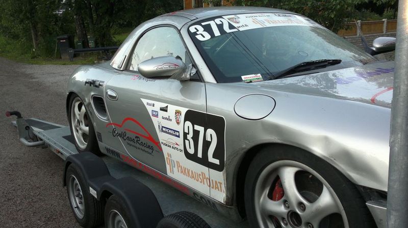

So, my last post was early in in the 2012 season after the crash at Ahvenisto. To shorten the story and get us closer and up-to-date. I and the CoolCava Racing team had a great season. As a team we took 1st, 2nd and 3rd overall in the Sports Cup and 2nd overall in the GT3 Cup Trophy. Personally I took 1st in class and 2nd overall which I think is not to bad for my 2nd year racing :)
The not so bad part was that during the season I had two accidents. The first one I noted in the other thread when I took a corner wrong and ended up in the tire wall. The second time was another driver that failed to take a corner and drove straight into the side of my car. So by the end of the season I had damage to both sides of my car :( This is how my car looked by the end of the 2012 season...
http://986forum.com/forums/uploads01...1367314422.jpg
http://986forum.com/forums/uploads01...1367314435.jpg
http://986forum.com/forums/uploads01...1367314451.jpg
But as someone who does try to always look on the bright side, I decided to see this as an opportunity for improvements, and generated a nice long project list for the winter and to get ready for the 2013 season - which starts at the end of next week :)
