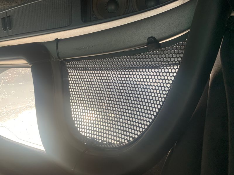

I installed mine with black zip ties. Solid repair and discourages those who might want to steal these parts when parked with top down, apparently that happens too often.

I use 4 black cable ties on each one to deter thieves. Guess I've been lucky for the past 20 yrs.

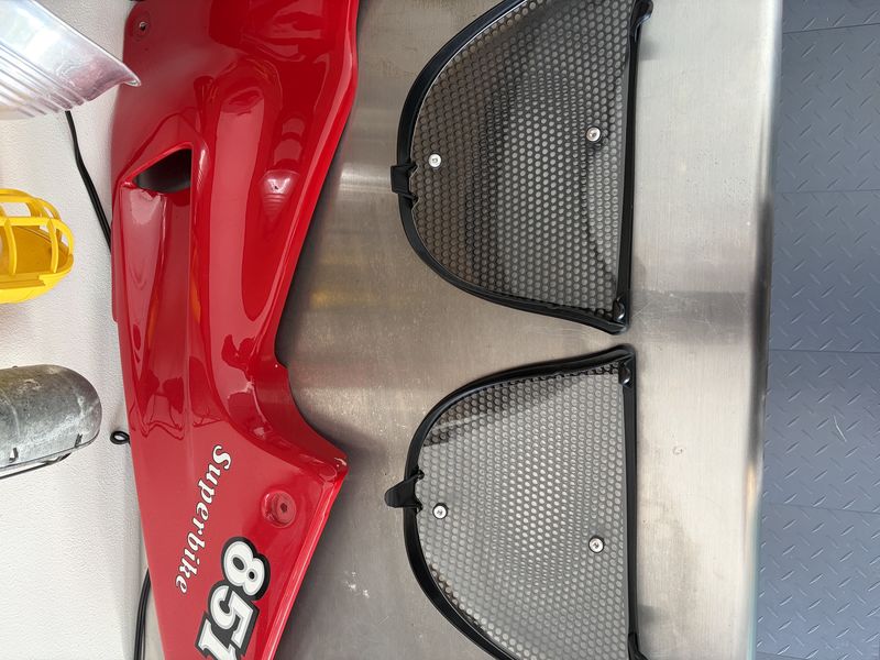

There are 3d models around you can print, but the ones I've seen don't have the tabs so you'd be in the same boat. I just made some out of aluminum hex mesh and zip-tied them. At some point I may get around to making 3d printed mounts for them, but it's very low on my priority list.

I don't get the plexiglass you have on the parts. Wouldn't that defeat the purpose of the part? Why wouldn't you just cut some Plexiglas and wire that in?
