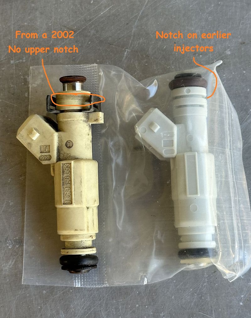

78F350 11-09-2025 07:36 AM
The injectors on the rail from the 3.4 should work fine.
The injectors from the 2001 should work fine too.
The change to the non-return fuel system occurred in the 2002 model year. Injectors should be the same as 2000 & 2001 except for the second notch missing on the later injectors. The main difference is that the fuel pressure regulator is in the tank as part of the fuel sender unit rather than at the rail on the engine.
http://986forum.com/forums/uploads02/inj1762717869.jpg
Ike84 did an interesting thing a few years back: https://986forum.com/forums/diy-project-guides/80079-986-2-injector-retrofit.html

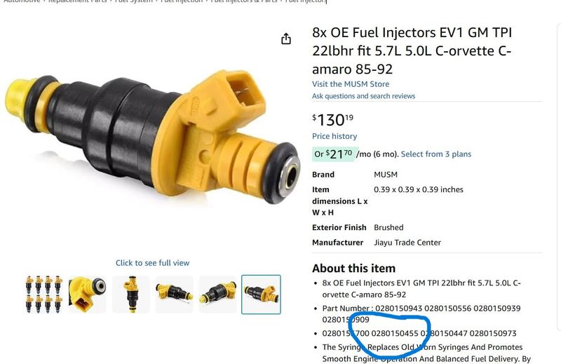

Dllrd23 11-21-2025 03:59 AM
Did find this interesting when searching for injectors for a 99 Boxster. Yes, I know, it's Amazon and their cross and is probably highly inaccurate but still worth asking. Is this true? Has anyone tried it?
