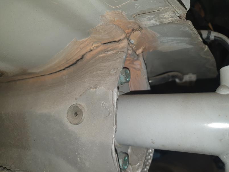

To work on the exhaust, I have removed the rear bumper cover and bumper. Yesterday I noticed a sort of crack in the glue kind of stuff on the chassis, see picture below. On the left side of the car (where this picture is taken) it runs quite a way forward. Also around the rear part. On the right side It is only visible around the bumper post, not running forward along the main chassis beam.

1. What is this glue kind of stuff called?
2. What would be the cause of these cracks?
3. Are they structural or only cosmetic?
4. Any advice on a fix?

Hello Marc, is the white round part on the right part of the picture, the bumper strut?
If so, the glued section (cracked), perhaps was caused by a light impact on the bumper causing the dried glue to crack..? :rolleyes:

Yes, that is the bumper strut indeed. The car has taken a hit sometime in its life and this is most noticeable in the right rear. The longest crack happens to be on the left...
Any advice on this?
Any advice on this?
IMHO, I would only fill the crack with new sealant, to keep moisture and water away, I seriously doubt that the frame/body is damaged by the impact, but to be sure you may want to meassure it to see if you find any discrepancies.
