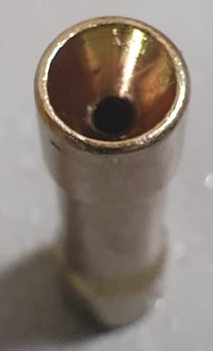

Just another question (to you or anyone else using the Astra / Opel / Vauxhall pump). There was a bit of return line on the pump when I got it and which I wanted to re-use. Funny part was that it had a crimp on it, close to the reservoir. That was a bit odd, also as it didn't seem to be for connecting hoses together.
So I cut the sleeve off and managed to pull something out which seems to be a reducer. I didn't measure, but by sight it looks to be about a 3mm hole through the center. Did your pump come with such a restrictor? I guess you didn't put any restriction in, right?
I can't really understand the use of it yet, it looks like it would be the biggest restriction in the whole system. And why would they run a 10mm return line when they want pressure drop anyway? Bit confused.

Thanks. I searched around a bit and found only one story on this. This stated that the pump on the Astra is physically very close to the rack and this proximity led to pulsing which was noticeable while steering. It was stated that this restriction is the remedy.
So as for me the pump has a good bit of hose before it reaches the pump, I am going to leave that restriction out. If I do notice something, I know what to do
