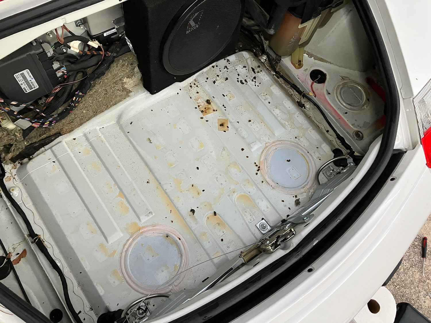

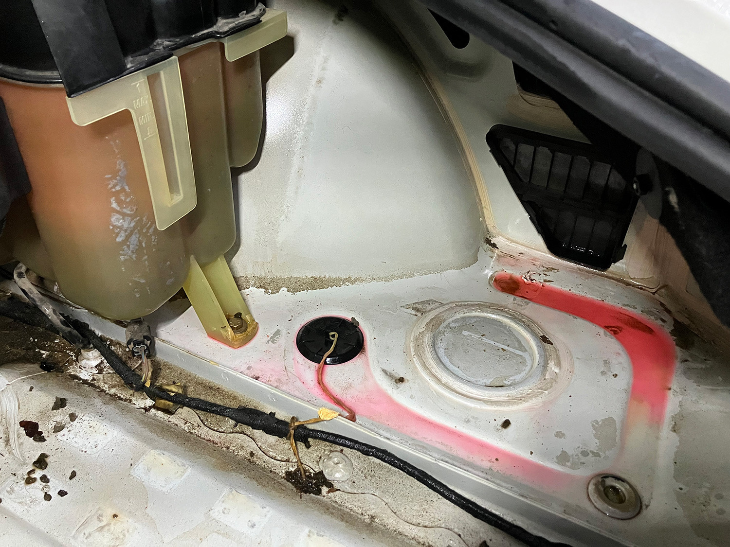

Then I removed the trunk liner and saw this:
https://cdn.bsky.app/img/feed_fullsi...5yp75njy4@jpeg
https://cdn.bsky.app/img/feed_fullsi...uk7puctcm@jpeg
(yellow is old coolant, red is newer coolant)
The tank is leaking, right? If so, how does the coolant make its way down on the chassis braces in front of the rear wheels? And over that far to the left in the trunk?

Yes, by gravity
Spannerhead 10-04-2024 08:41 AM
Right, but where is the path? Are there drain holes at the front of the trunk? It just seems like a long way to go from the front edge of the trunk to the chassis braces in front of the rear wheels (and then onto the splash tray)? It makes me think there might be something else/besides the tank leaking.
JFP in PA 10-04-2024 09:02 AM
There are about a dozen or so places where it can leak thru.

Why does it matter? Just replace the tank and call it a day.

Because the drips are a long way from the tank, and I was wondering if there were other common sources of leaks closer to the drip locations that I should look for and address in addition to the tank.

BUT. Do the drips in front of the rear wheels (a long way from the tank) point to a bad tank? Or is there a hose closer to the drip location that could be leaking?
I'd feel pretty stupid if I replaced the tank only for the car to still be leaking from somewhere else. That's what I'm trying to determine.

If you are that concerned, add some UV dye to the cooling system, after circulating it for a while, pressurize the system with something like the Stant system test tool, put the car up in the air and look for where it is coming from with a UV light.
Homeoboxter 10-04-2024 06:44 PM
A less sophisticated but simpler test is to pour about a quart of water into the trunk below the coolant reservoir. You will need to clean up that mess anyway. Then you just follow the route. If you see the water accumulate at the same places where the coolant did before, you can be almost 100 percent sure you have only one source of a leak. Good luck!

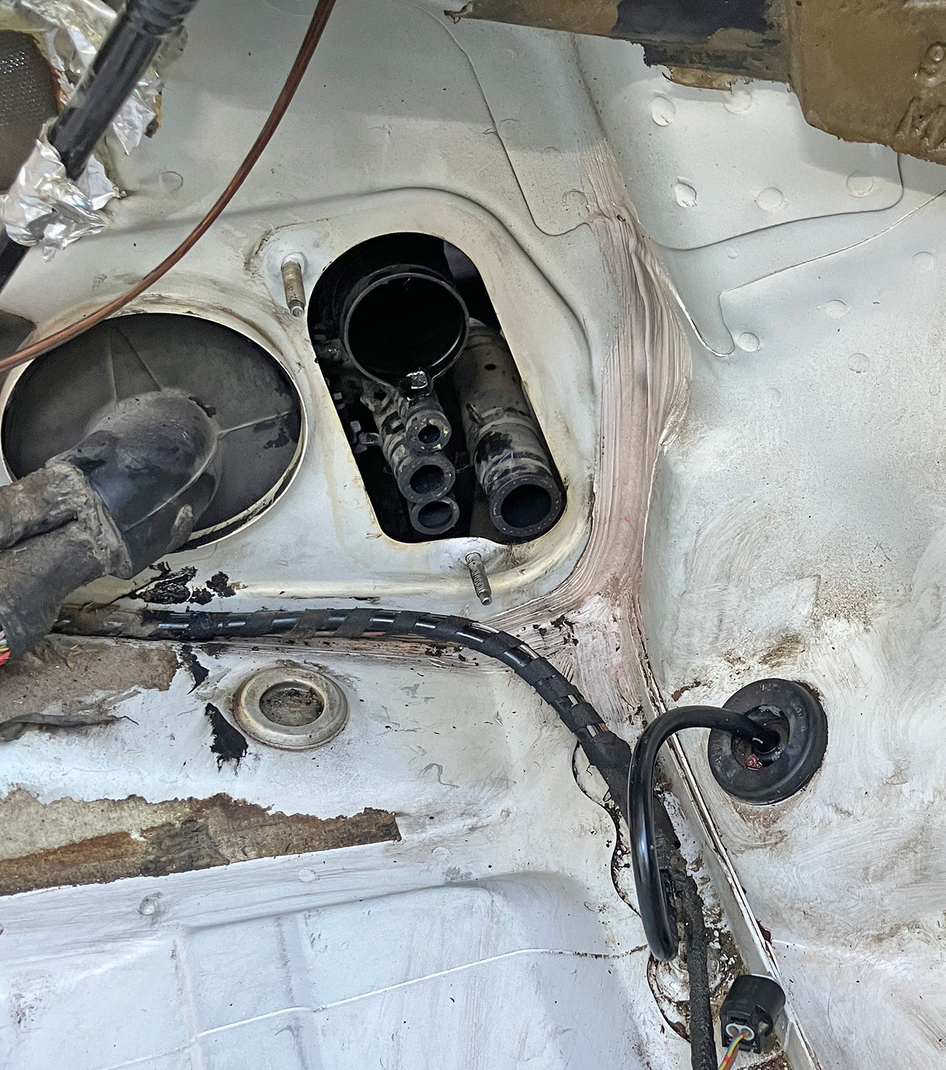

There are multiple hoses that connect to the coolant tank at the firewall. You will have to disconnect them all when you replace the tank that is clearly failing. Those hoses are short and connect to metal tubing that leads to the front of the right rear wheel. Inspect them when you replace the tank. They rarely fail.

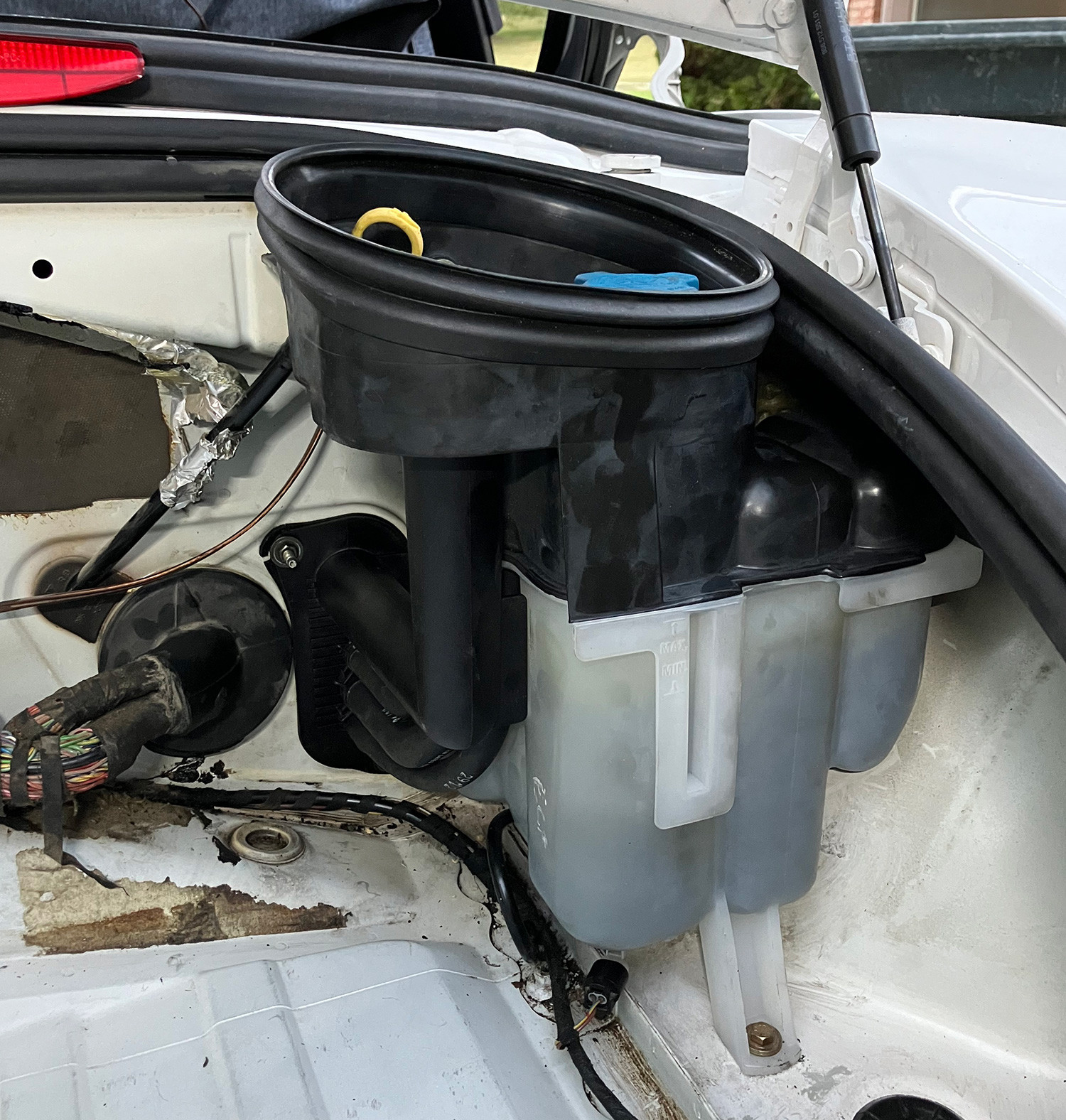

I replaced the water pump & thermostat about a month ago.
Got the new tank in. Not too hard.

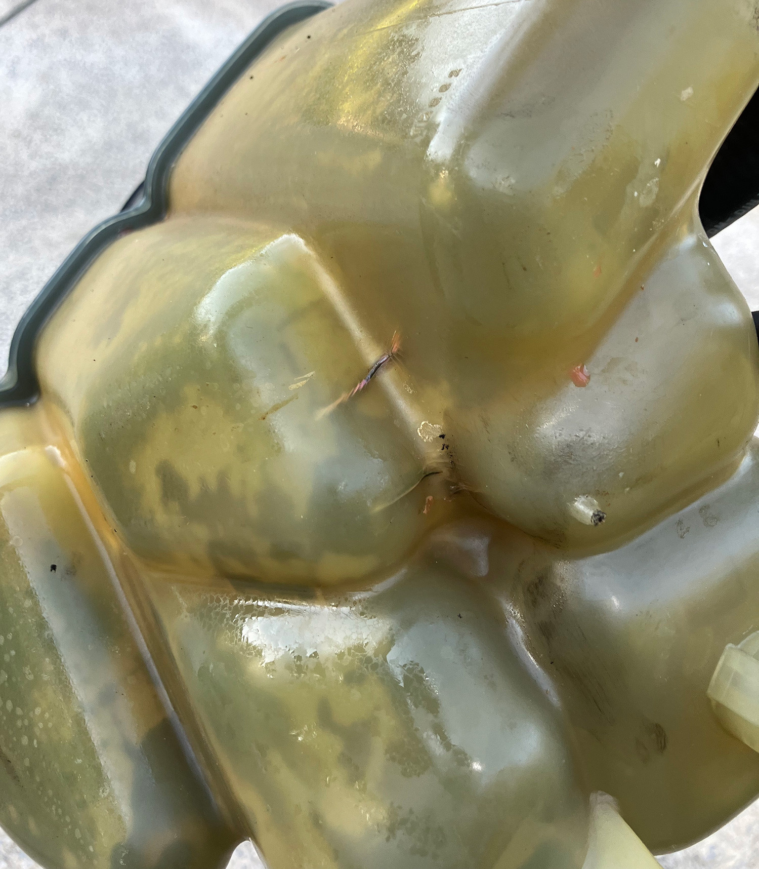

https://cdn.bsky.app/img/feed_fullsi...tgx6usyfi@jpeg
https://cdn.bsky.app/img/feed_fullsi...v4vnn52ui@jpeg
https://cdn.bsky.app/img/feed_fullsi...yegu5psxu@jpeg
Looks like some stress cracks in the base of the tank.
I reattached the hoses through the engine bay top opening because that way I could be sure they were snug against the plastic plate. The oil filler tube was a pain.
Still find it weird coolant managed to find its way all the way in front of the rear wheels from the trunk. Also, this is probably the most overcomplicated cooling system I've worked on. And I've owned 4 BMWs, lol.
No leaks I can see. The low coolant warning in the tach flashes (the slow flash) for about 10 seconds on startup, but then goes off, though. Even after a few drive cycles. From what I read, the sensor is kind of flaky?

There are 4 hoses going to expansion tank through a bulkhead and hoses are clamped to the bulkhead on both side, so that might be another source of leaks. If you have a coolant system pressure tester kit you can test pressure and see where the leaks is, you can rent one from you local auto part stores.
