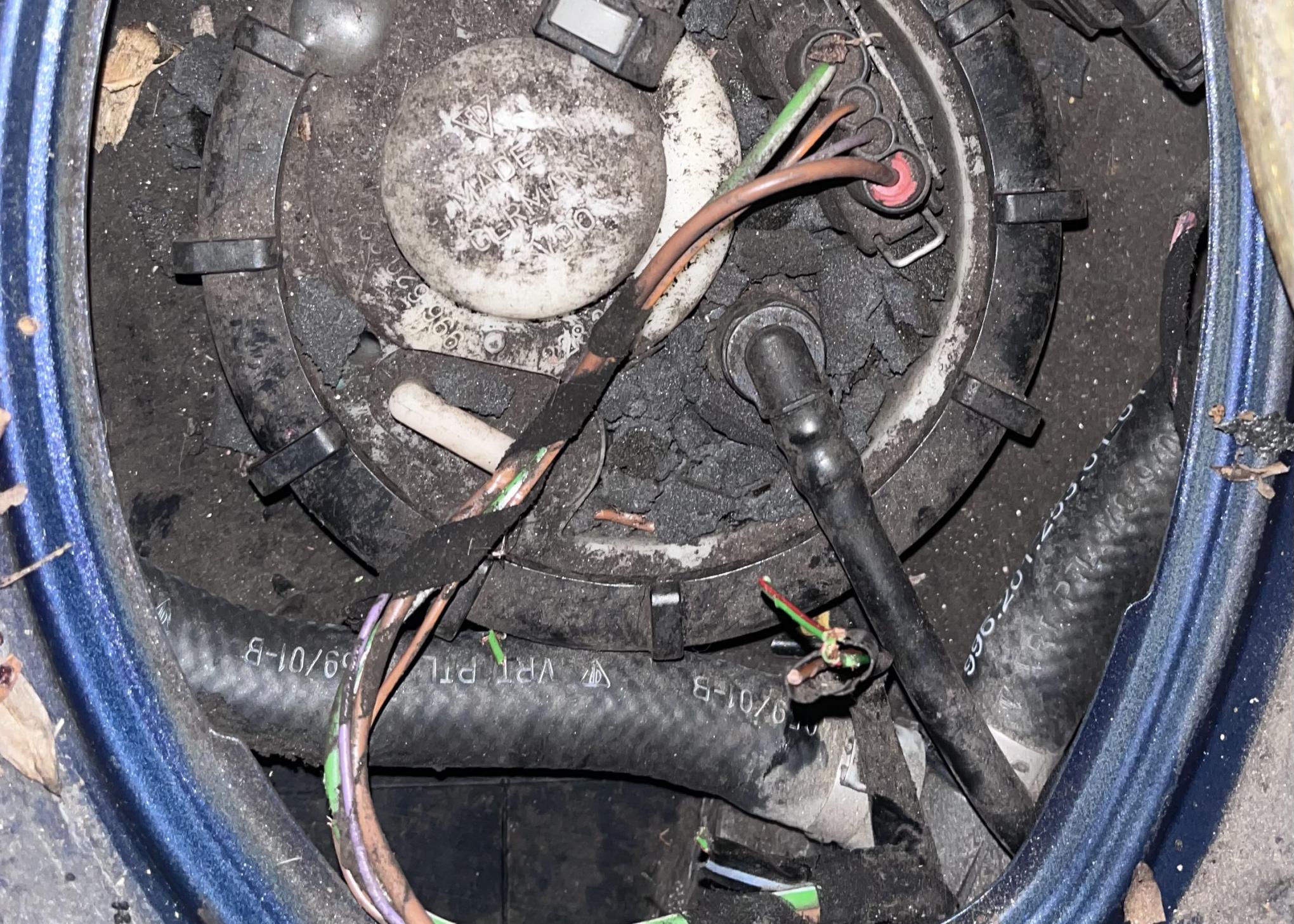

Hi all, have a 986 S 146,000 (100,000 me) runs great but had trouble filling tank so replaced the vent valve. No dice. So in search of a leak due to the codes p0450 and. p0455 I removed battery & support and find a mouse chewed through what I believe is the wiring to the EVAP sensor. See picture. And it is crazy how dirty it is but I will address that!
Questions, am I correct that this will throw those codes and how difficult is it to replace the wiring harness that was eaten? I have done a lot of work myself including replaced top, crankshaft position sensor etc. so have some ability. Anyway, can I repair thiss myself? Many thanks in advance!

It might require a new ‘whatever’ is on the end of those wires. But I would venture a yes.
spinjockey 06-22-2024 09:59 AM
I don’t know for sure but that harness may be connected to the body harness which goes all the way back to the trunk. Replacing the body harness isn’t what you want to do. I would splice in new wire and redo the ends all the way to the connector on the fuel tank.

All, resolved. Must have been the wires to the EVAP sensor. I spliced the two wires that the mouse chewed and that fixed my main issue - car would not take gas. I had already replaced the vent valve as google tells you that is the most common symptom. Also so far no codes but because battery was disconnected I need to car to get some miles to confirm. That said very happy. Also no apologizes, to big picture guy, that is how this forum takes them and they look fine on a mobile phone :)
