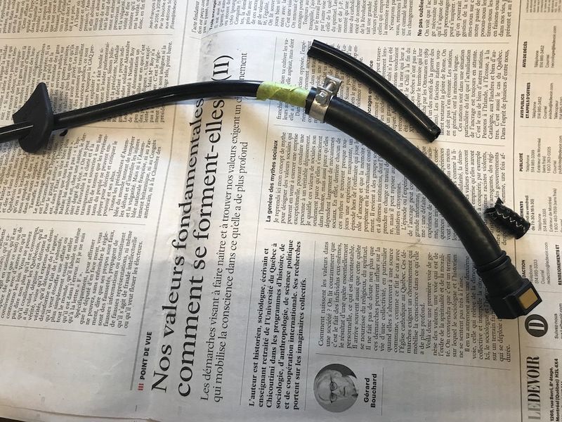

The dipstick tube is so brittle that it broke near the engine side connector while I was trying to reposition it. I used a length of 3/8" rubber hose to fix it.
Mine did the same when I was trying to take it out, and I've repaired it the same way. I see now that I need to undo it an put the firewall cover on first, hopefully it doesn't break again farther up...
