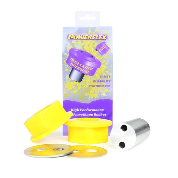

Originally Posted by Radman View Post
Replaced my motor mount with the Yellow Power Flex bushing. This thing is like a dream compared to the old insert that literally fell out when I took out the mount. Some have complained about an increase in vibration but I didn't notice that at all. It felt great.
Can't stress enough how much better the car felt with the Power Flex insert. Impressed enough that I'll go with them for the sway bar bushings when I do them.
Are you still happy with the Powerflex? Is it this one?
nuvolari is offline   Reply With Quote

Yep, that's the one and I'm still very happy with it. I can't really compare it to stock though as my original mount was completely shot.
