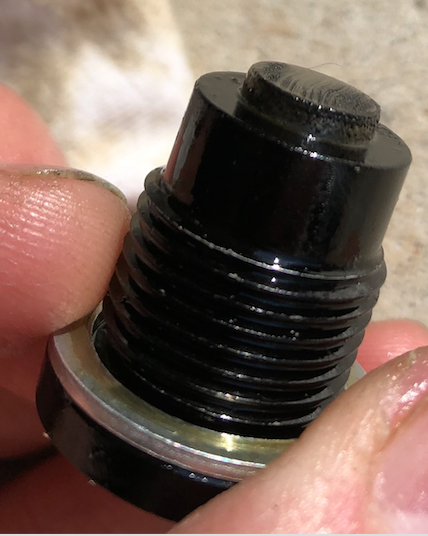

If you over torque this can happen:
http://986forum.com/forums/uploads02...1596255675.jpg And it will leak. I don't know my own strength sometimes. :eek: Seems like I did over a 1000 oil changes on my first Boxster, and this plug had been torqued a number of times. |

I tightened the LN plug by hand, then with a normal socket wrench until I felt a little resistance, then went in with my torque wrench. But I noticed the torque wrench wasn't clicking and I wasn't getting an increase in resistance as the plug tightened. Then I noticed that the threaded part had sheared off of the head and was spinning deeper into the oil pan as I tightened. The remaining oil started to drip out. Thankfully the previous owners kept the original factory drain plug in a parts bin. The LN plug had been on the car for 15,000 miles and 6 oil changes. I'll post pics if I can find them on my old phone. If the same thing is happening to you, I would not tighten the plug as it is already shearing. update: the LN plug that broke was purchased from Pelican Parts in April 2011. Part# LN-106-07. I recall the plug needing a different size and/or type bit (not the 8mm hex like stock). The more I think of it, I don't think the torque spec was written on the head. I feel like I would've seen that and changed my torque setting. I knew some kind of aftermarket magnetic plug was installed and I later noticed the purchase of the plug was documented in the car's logbook so there's still no excuse for me applying the wrong torque. I'm confident the owner who purchased the plug torqued it properly for oil changes 1 and 2. But changes 3 through 6 probably left the plug no chance of surviving based on the mixed bag of people who performed those oil changes. Here's the LN plug: Attachment 22491 I didn't think to take any other pictures (even after it broke) |

....is less than the OEM plug because the magnetic part inside the outer plug body can “spin” inside the plug body if you over torque it as I explained above.
The Magnet is not aluminum. The Plug is aluminum. You have two different metals and vastly different hardnesses. So if you torque the magnetic plug to the same level as the OEM plug, the magnet inside the LN plug can break away from the outer ring and spin and you will leak oil. |
