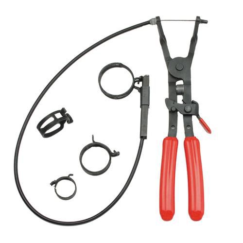

por356c 04-05-2020 05:40 PM
What is the hose clamp removal tool? Thanks.
Paul 04-05-2020 07:05 PM
https://shop.advanceautoparts.com/wc...6_pri_larg.jpg
https://s.shld.net/is/image/Sears/00...sm=0.9,0.5,0,0
GLImages 04-06-2020 04:39 AM
+1 on getting the clamp tool. It definitely makes it easier.
