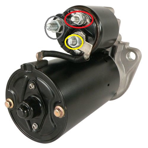

There are two wire posts. One is a smaller diamter post, and to that I atached the funky looking connecter. All good.
For the other post, the larger one... I had two wires to connect. Both fairly heavy duty (think battery cable). One of the wires slipped right on. The other wire took a bit of tugging, twisting, and pulling. Finally got it on... tightened down the bolt.
Reinstalled the throttle body... tightened everything up. All would seem well.
Went to the frunk. Positioned the positive cable to the positive post. When I put the negative cable on the negative post... a nice big spark. Left it on for the 10 seconds it took me to turn on the ignition... no dash lights at all... then disconnected both battery cables.

Are you sure both of the heavy duty wires go to the same post? Isn't one a ground wire, and the second the battery wire? Please double check the two big wires.
Just a thought.

See pic 5.

Yes... one of the wires (the one I had to massage on) is grounded to the top of the secondary air pump on the passenger side.
The other wire... from where it originates I don't know... but it was clear it went to the larger post. It fit right on... and I had disconnected no other wires.
"I haven't done this job on my car, but here's the Pelican article on it: https://www.pelicanparts.com/techarticles/Boxster_Tech/83-ELEC-Starter_Replacement/83-ELEC-Starter_Replacement.htm
See pic 5.
I had seen that pic... and it didn't help me at all.
Thank you, both, for the input. I remain flummoxed.
The yellow circle wire was a no-brainer.
The red circle has the smaller diameter post... and that connection came from the left... the wire coming from the small loom with another wire connected to the part that snaps onto the electrical connection on the throttle body.
The grey circle is where I connected the two heavy duty wires (one of wires took some massaging to get on the post).
I don't even want to reconnect the battery. Perhaps I blew a fuse. However, I first have to identify if properly I reconnected the starter. It's not rocket surgery... and it appears the heavy duty wires went where they were supposed to go. I'm lost.
Any other ideas? Thank you.
Attachment 22291
Edit: OK. I see what you're saying, Eric. That wire from where I don't know it comes likely is from the battery... I'm thinking it comes fronm the square box with a positive wire goint to the altrnator. So I guess a new question is:
Should that wire go to the red circle post? That would mean that there's two wires connected to that post. Should there only be one of the heavy duty wires... the ground wire coming from the top of the secondary air unit... connected to the larger post? Should there NOT be two wires connected to that larger post... and I was incorrect trying to put both heavy duty wires on that larger post? That would mean that I connected both a ground and positive wire together... and on the ground of the starter. Should there be two wires connected to the red circled post?

When you were tugging on that wire, you potentially shorted it to ground. You'll want to start there. Indirect that wire it's full length.
Oh, but first: I've often seen the round loop connector get chocked just-so, and it touches the body of the starter or solenoid. Check that first.

The ground wire I "massaged" onto the starter... HUGE error. That wire I was supposed to connect to the bottom bolt connecting the starter to the motor. Damnit.!
So... I'l pull off the TB... remove that bottom starter bolt... and affix the ground.

If your second heavy wire has a flat lug with a notch in it, it should bolt onto the red circled bolt. It should only fit one way, the notch positions it. It is position so it can’t touch the other large wire from the battery (black box you mentioned).
Let me know if I can clarify further.
-Eric
