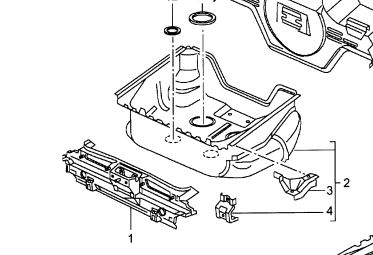

9864ever 01-17-2020 11:11 AM
This is great thank you. Since the tub looks to be ok, based on the diagram it looks like Part A is what I need and maybe the left side could be pulled back into shape. All the damage was above the frame rail - then again, it needs to be checked.

9864ever 01-20-2020 01:45 PM
Part needed
I had the owner of a shop come out today to see the car and he said it's very doable but said I need to replace the front piece which is #1 in the diagram. I have found entire front clips available but he said its not needed.
Currently looking for part #1 if anyone knows where I can get one or has it please let me know :)
I called the dealer and I can get it new as well and has to be ordered from Germany so that's my last resort.
http://986forum.com/forums/uploads02...1579556664.jpg
