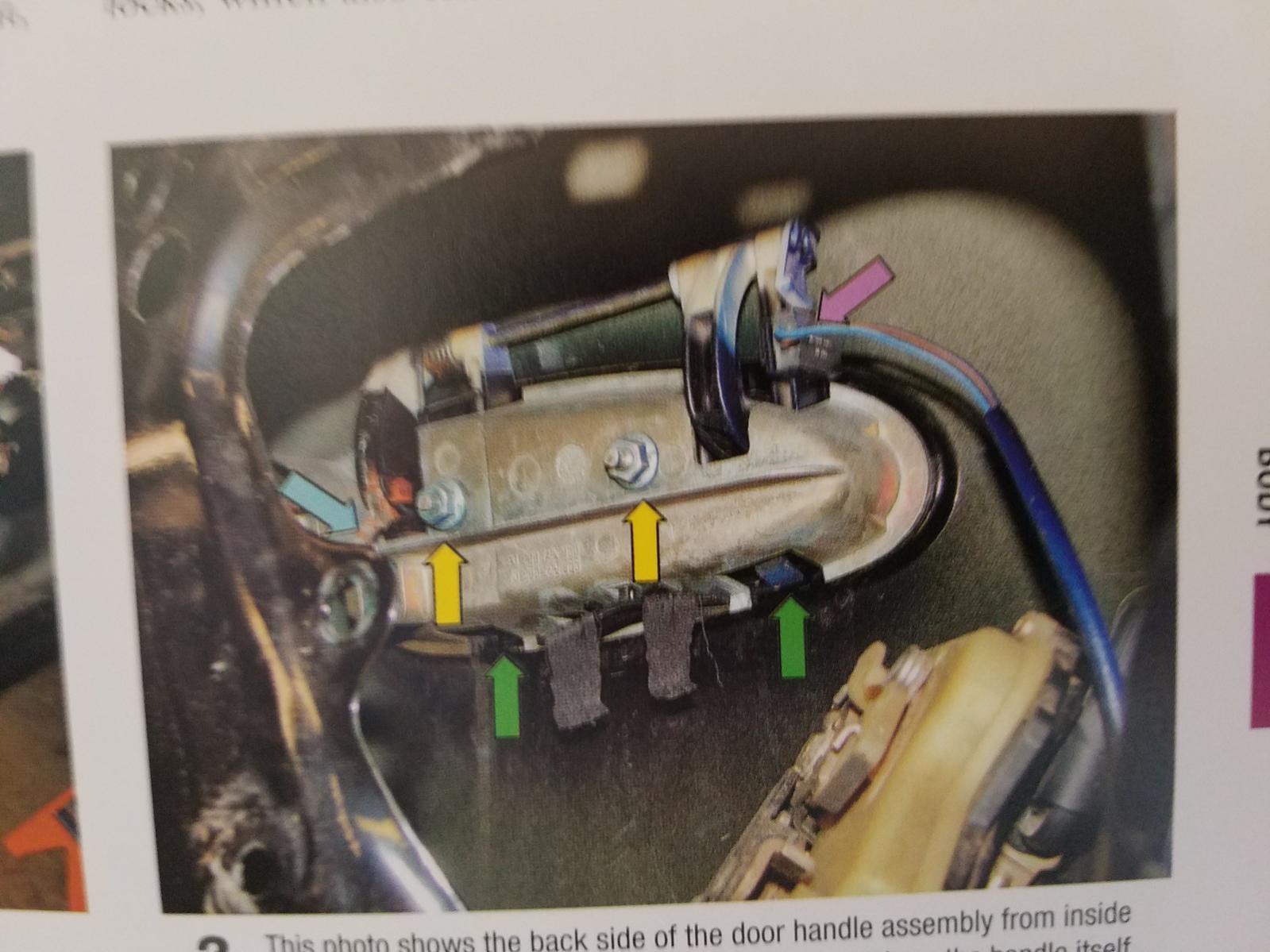

Box7774 07-22-2019 08:16 AM
This is like doing a puzzle. I have no idea how we used to do this without the internet. I guess we just paid the man. So this is what I have come up with so far. Particle Wave has been on point since the beginning but didnt spoon feed me the " how to " portion of replacing the door switches :)
I found the door micro switch that supposedly functions as the window drop down via the door handle.........I am going to try this first before and window regulator work because it is easy and cheap. I have now discovered Pelican Parts.....Lots of good info over there.
Here is the part that I will be trying. If anyone has a vid on how to install please let me know. It looks to be just plug and play...but I am crossing my fingers that i dont have to remove the airbag to do so.
see link
https://www.pelicanparts.com/More_Info/99661312500M100.htm?pn=996-613-125-00-M100&bt=Y&fs=0&SVSVSI=1047
78F350 07-22-2019 09:33 AM
Originally Posted by Box7774 (Post 599742)
... I found the door micro switch that supposedly functions as the window drop down via the door handle.........I am going to try this first before and window regulator work because it is easy and cheap....
Having found PelicanParts, you have probably seen the Tech Articles, but here's the link just in case:
https://www.pelicanparts.com/boxster/boxster_tech.htm
Most of it follows the 101 Projects Book, but being online there is a comments section and additional pics.
For the microswitch, I'd use a multimeter and test the switch in place before buying a replacement.

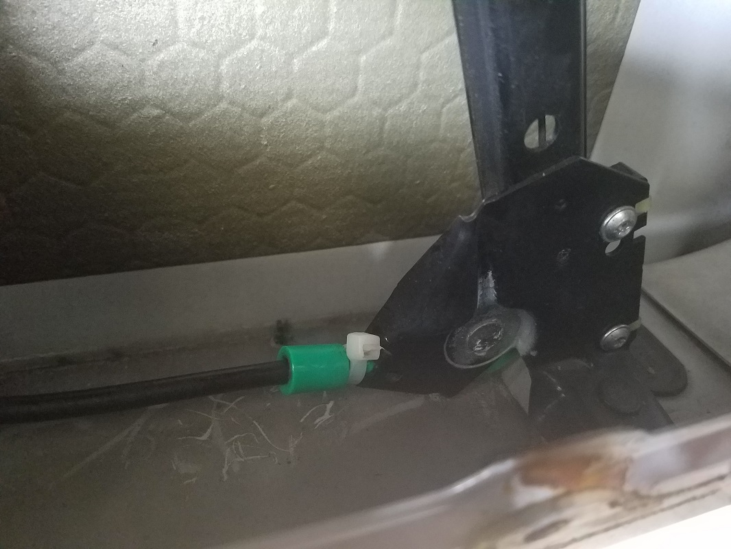

Box7774 07-22-2019 02:44 PM
THIS JUST IN.......HOT NEWS!!!! I felt like I was letting u guys down by not removing the entire inner door insulator and speaker assembly. Its one thing to ask a bunch of questions but I know I need to do my part.
So here are the clues I was working off of.........
PW said his repair was on the front green spacer.....nobody else has reported this as far as I know...but the thought was lingering in my head...gotta get to that front spacer!
When I manually push the window down with my hands it seemed to sink in the front more then the back.
There were no grinding or bad noises that would indicate the regulator motor.
There was zero play with front green spacer and cable
The inner handle seemed to work but just barely.
All that said I bucked up and got on my knees before the 986......gently removed the foam insulation and the speaker box and there before my very eyes was the frickin front green spacer!!!!!!!!!! I gave it a mighty yank and low and behold .....SLACK...........AND LOTS OF IT!!!!! Tried one zip tie with minimal luck.....tried 2 zip ties together and without celebrating too early I do believe the window is now on the move.
Anyone wanna buy a micro switch? :)
My next conundrum will be .....do I get a bicycle adjuster and figure out how to install the thing.......or are zip ties a lasting repair?
particlewave 07-22-2019 02:50 PM
Nice sleuthing :cool:
I don’t think the zip ties are a long term fix, but you can probably button it back up, order the bike cable tensioner, then tackle it a month or two down the road. The zip ties should last that long. ;)

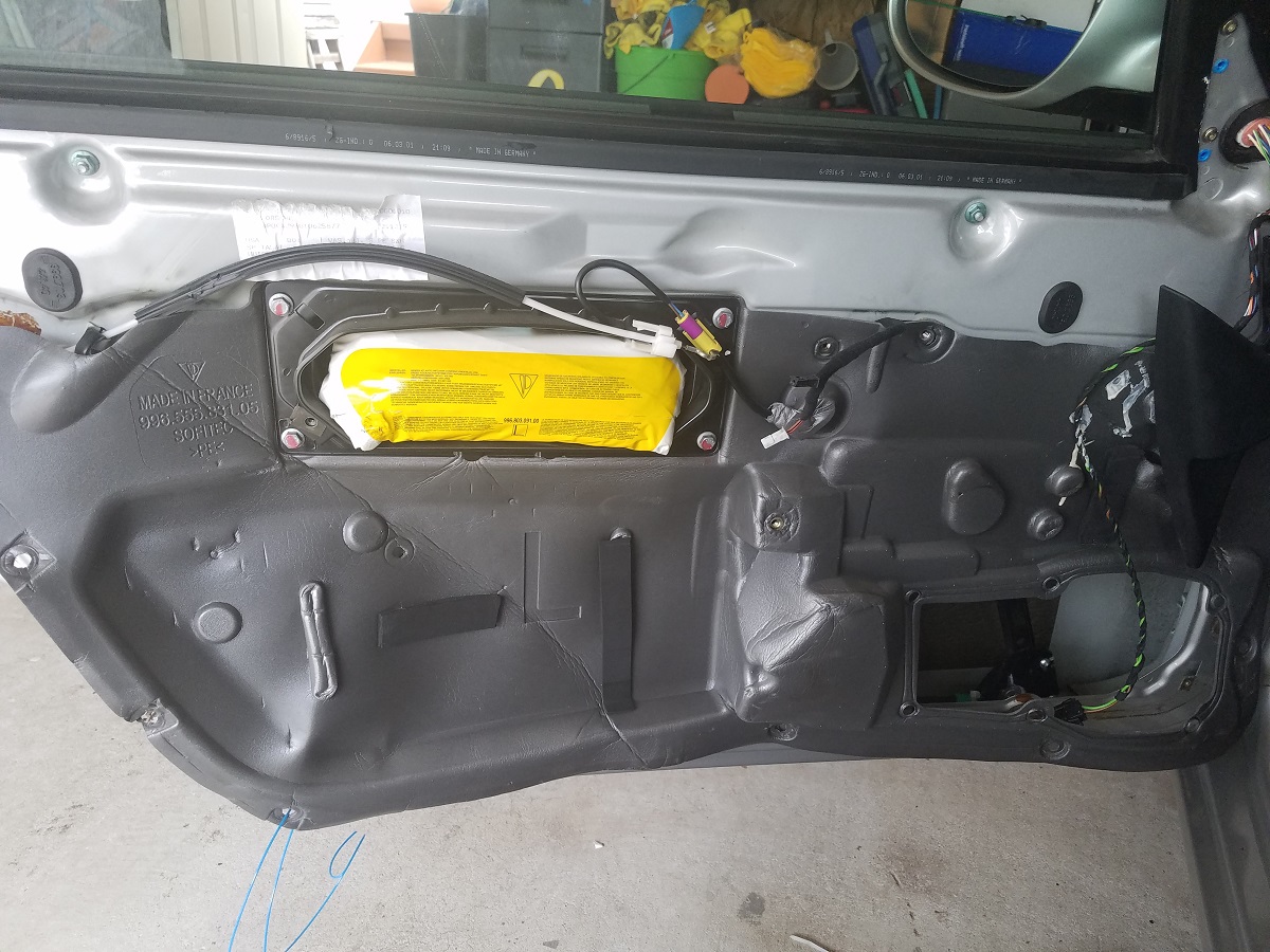

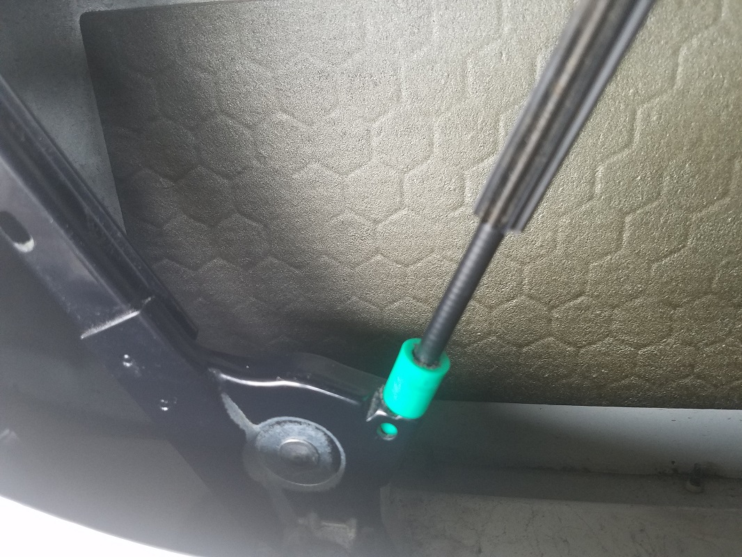

Box7774 07-22-2019 04:10 PM
3 Attachment(s)
Dont judge me..........but this thing has frustrated me so darn much that I have walked out to the garage 3 times just to watch it work.
I am hoping the passenger side door is just the same issue but it seems odd especially since a passenger door doesnt get the use that the drivers door does.
So all, thanks for getting me through issue #1........special props to PW....there should be a thumbs up icon but I dont see one....so just imagine it ok.
My wife probably thinks I am a great guy and just tuning up her bicycle......ha ha.....she hasnt ridden that thing in years. I would bet u $100 the day after I remove the tension-er she will want to ride her bike.
Anyway....how in the hell do you install the tensioners? Do I have to break a perfectly good green spacer then somehow un clip the nub on the end to run through the part then hook back up? I will start to search for those threads now.
Here are some pics of my door.....I installed zip tie number 2 after the pic
