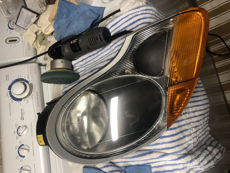

My headlights had a yellowness to them I really didn't like. So this past weekend, after weeks worth of studying up I decided to go after them to make them clearer. I haven't had a DIY project go so bad in a long time! I've since learned what I did wrong. I wet sanded my headlights with 600, 800, 1500, 2000 & 3000 grit sandpaper. They looked so much better I took it further with my Novus plastic polishes and my Porter Cable polisher. I thought they turned out great. Much better than they were. (see the attached image and yes that is my "workbench" when I am working with water!
The disaster step was applying a clear coat recommended on a Youtube video, Rust-oleum 2X Gloss Clear. It instantly turned milky, checked and clearly was not the right product for what I had prepared. Seems there is a reason you stop at a consistently cloudy surface after wet sanding to give a product like the Rust-oleum something to bond onto. My polished surfaces didn't allow that even thought I had wiped them down with alcohol to ensure they were "clean." I let that clear gloss paint product dry then sanded it all off and started over.
I know I need to apply a UV protective layer or they will quickly yellow again. I did read Particlewave's recommendation the best way is to have a professional shop do the clear coat. And I may have learned my lesson the hard way he is right. But, I just have to inquire if anyone has successfully used a UV protection layer on polished up headlights? The 3M Quick Headlight Clear Coat wipes caught my attention, so I just have to ask if anyone has used them successfully?

Yep, that's the stuff. I never detailed any method, but I've used it on headlights and my rear bumper after a small paint repair.
I start with either 200 or 400 grit, depending on the condition. If there are actual divots in the plastic from rock strikes, I'll use the 200 as it is very aggressive. Otherwise, a moderate sanding with 400 to remove all of the old clear, then 800. I don't recommend going much higher than that, but maybe my experience is different from others. All wet sanding, BTW.
The 800 leaves something for the clear to bite.
I've also never had any luck with multiple coats. I usually just lay on one thick coat, which is tricky to do without runs, but once you get a feel for it, it gets easier.
The bottom line? If I had to do it again, I'd probably just ask a paint shop. It's a pain and so many things can go wrong.
