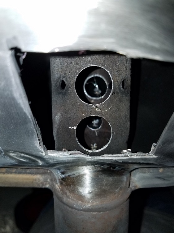

Yeah the holes must not be big enough. Did they at least drill the holes all the way through the pipes? As you can see what I did in the internal bypass thread, two holes each side around 1 inch. Then I used a chisel to connect each hole. I can definitely hear the difference in the car with the windows up. With them open and the top down, big difference. Under a bridge or in a tunnel it is pure GT3 mode. My wife says she can hear me coming down the street at 30mph. If I get on it people always look. So I would say the mod works if done right.

If he opens it back up drill 2 holes on each side, all the way though the pipe. I used a step bit, so I could only make the top of the hole full size. Both of the holes on the top of the pipe are 3/4 of an inch. The bottom holes are smaller. I put it back on the car with these size holes. I felt it needed to be louder. So I took the muffler back off and used a chisel to connect the holes. Basically I went through the pipes on the side of the muffler, placed a chisel in the hole closer to the end and hit it with a hammer until the holes connected.
