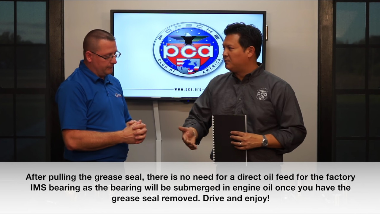

Just watched the PCA Spotlight: Types of IMS bearing retrofit kits youtube video that has Jake Raby in it and they put up a notice that you can remove the seal and there is no need for direct oil feeding.
https://i.postimg.cc/CxHTrSNf/ims2.jpg
So what's all the hype over the direct oil feeding solutions?
:confused:
Homeoboxter 04-10-2019 02:25 PM
:confused:
That`s what I`m talking about.

KRAM36 04-10-2019 02:53 PM
Man this pisses me off. Pedro is straight up lying. Pedro says the oil is lower then it actually is and the bearing will shed all the oil and does this on video. PCA says you can remove the seal and be just fine with the engine oil keeping the bearing lubricated.
My apologies Homeoboxter, you are correct.
