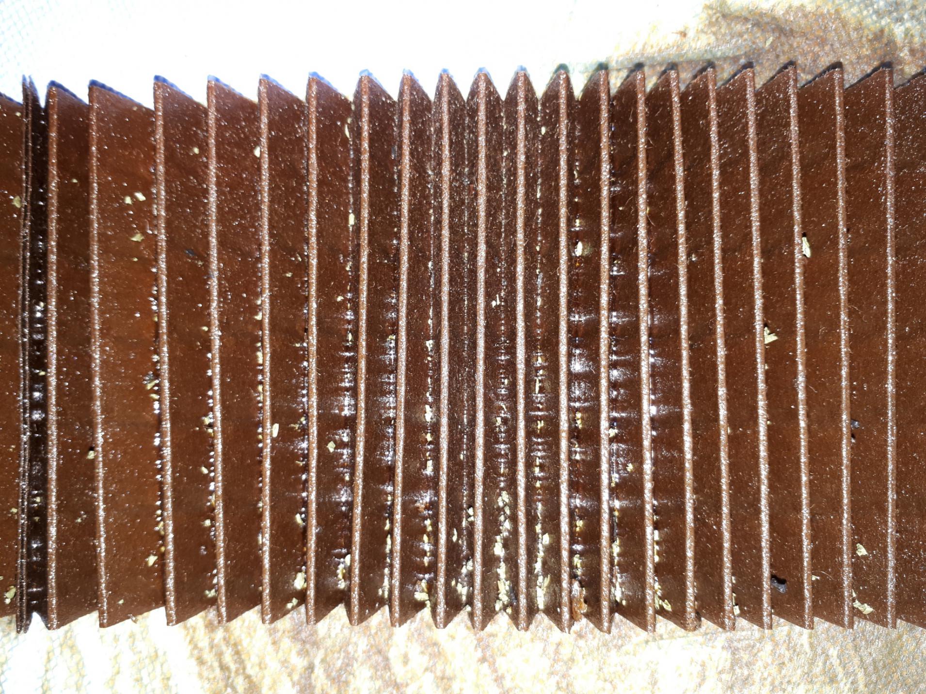

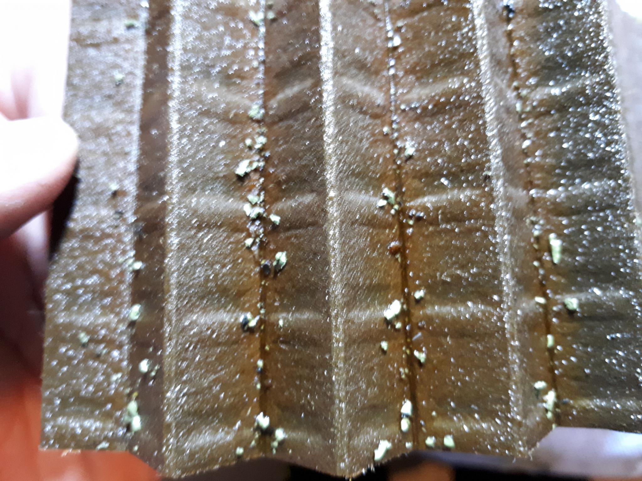

Hi,
Just completing on oil change on my 2002 Boxster and I cut the oil filter open and found a lot of debris in it. Can someone let me know if this is the IMS bearing or something else. Car seem to run fine with no noise or leaks that I can see.
Thanks for your help.
Attachment 21665
Attachment 21666
The Radium King 09-15-2018 04:07 PM
looks green and rubbery, hey - it's your variocam actuators if so. expensive to buy, and expensive to replace (engine needs opening). actually more expensive to fix than ims. run a magnet over it to confirm - if magnetic then engine probably done (symptom of metal on metal action - ims, but worn enough to have spit metal throughout the engine - good luck getting that out).
if actuators, engine can stay in the car if you take it to a tiny indy with tiny hands. otherwise any by the book porsche shop will drop engine and charge more $. total failure is not catastrophic put will produce a check engine light, loss of variocam action and loss of power. note that there is an actuator on each bank - check your cam deviation; big deviation on one side will let you know what side to replace.

krazy-knuck 09-15-2018 08:41 PM
OK, yes I just put a magnet on it and it doesn't pick it up and all the bits are green. What does these actuators do? Is my engine ok to still drive?
