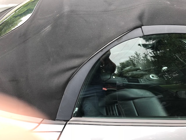

Let me add to this post rather then start a new one...The aftermarket top isn't closing properly, picture below. What to do for fix?
Attachment 21618
BoxsterSteve 05-23-2018 02:42 PM
Does the car have a replacement glass windowed roof on its original 3-bow frame?
They’re a PITA to work around.

10/10ths 05-23-2018 05:12 PM
You have an aftermarket top.
OEM glass window appeared in 2003.

Starter986 05-24-2018 09:37 AM
Originally Posted by tonythetiger (Post 571131)
alright, thanks. Is it common that an aftermarket top is difficult to work around...not get out of the way in service mode?
any tricks out there?
I am only getting about 5 inches of movement and cannot get to the engine.
That's the best you're going to get, and plenty of posts about it here. I've read that with the glass window simply remove a few fasteners from the clamshell and the top... and fold everything back straight. That should fix the accessibility challenge.
Before you start removing clips... pins... fasteners... make sure you remove them properly. I learned the hard way, and when I went to reinstall... had a few fasteners that had lost their efficacy. That was a visit to the dealer for $5 worth of fasteners... including spares. ;)
Remove the fasteners... and report back! :cheers:

Interesting, as I own an 02 with vinyl, fortunately still in great shape. So what causes this issue? Is the window, being glass, simply getting in the way? Seems it makes more sense to go big and swap the system for an 03+ when the time comes?
Deserion 05-25-2018 04:37 AM
Basically, yes. Since the 3-bow frame is meant for the plastic window, the glass makes it more difficult to fold up.
If you're able to, I highly recommend it. ;) You'd end up with a larger glass window on top of being able to fold it up easily. Plus the glass has the Porsche script on it so you can stare at it in the rearview, heh.
