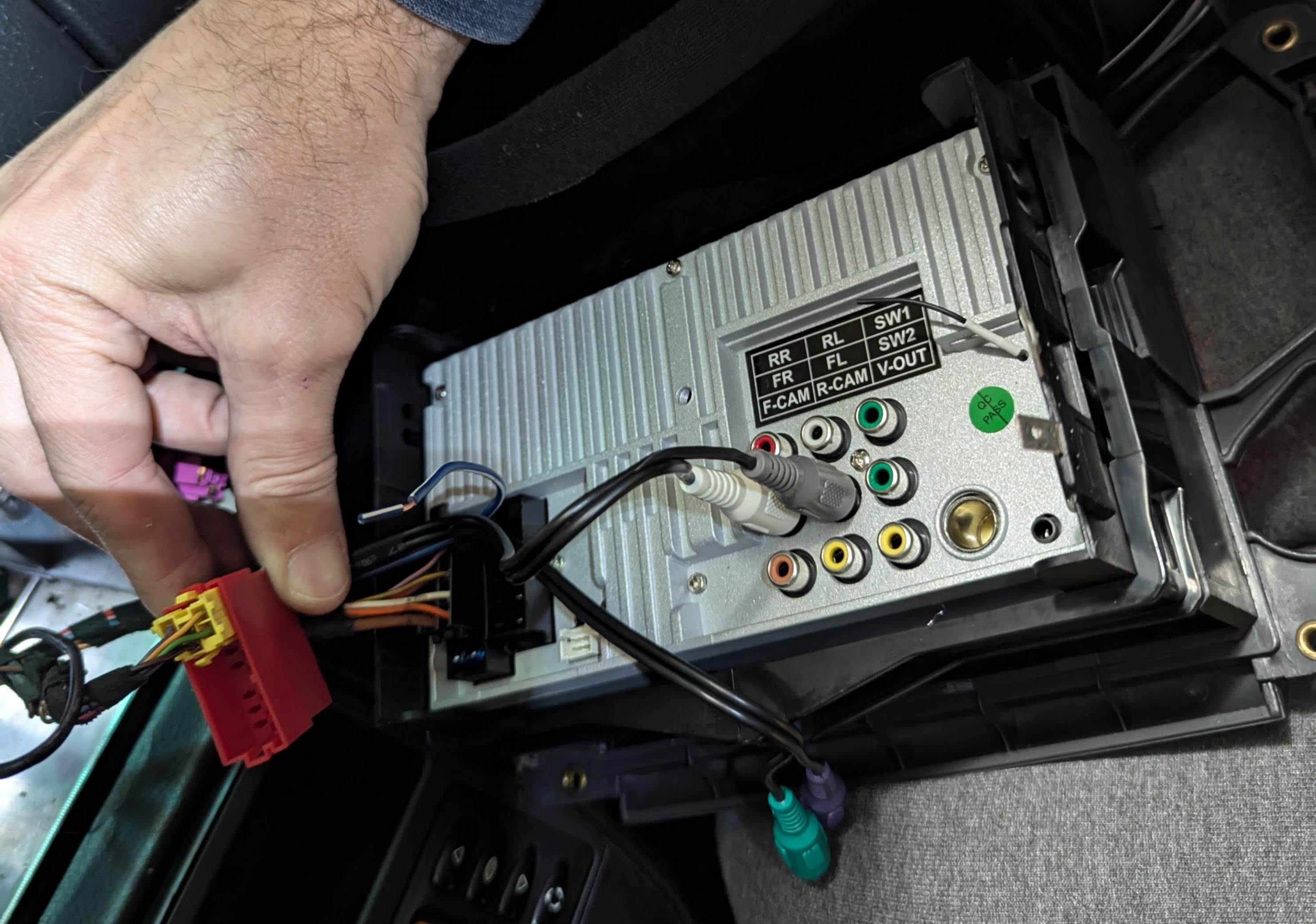

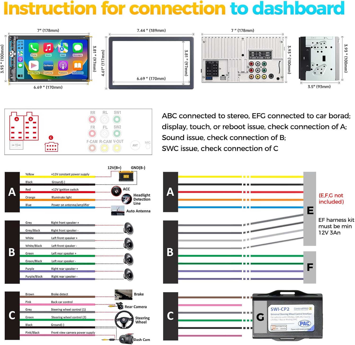

2 Attachment(s)
I love the idea of this, great find. I have an aftermarket double DIN head unit that I installed from Amazon. My 986 just has the standard amp and is not a BOSE model.
Based on what you see in the images below, does it look like I'd be able to successfully wire up the 987 rear speaker box to my existing setup?
Thanks in advance!
Attachment 23783
Attachment 23784

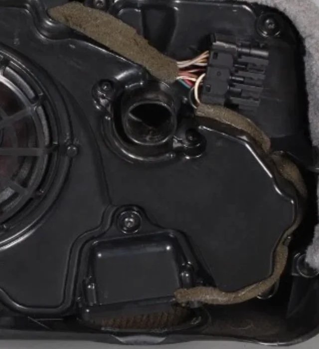

BoxsterInTheSun 07-09-2025 12:09 PM
Does anyone who has done this happen to have a wiring diagram of what the wires at the connector of the speaker shelf are?
Attachment 23785
