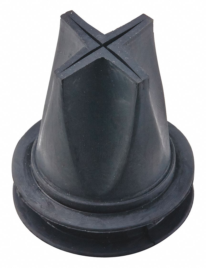

Paul 03-13-2018 12:18 PM
Maybe a smaller version of this would work (it's upside down in the picture), my 924S has these in the rear quarters.
https://static.grainger.com/rp/s/is/..._AS01?$mdmain$
