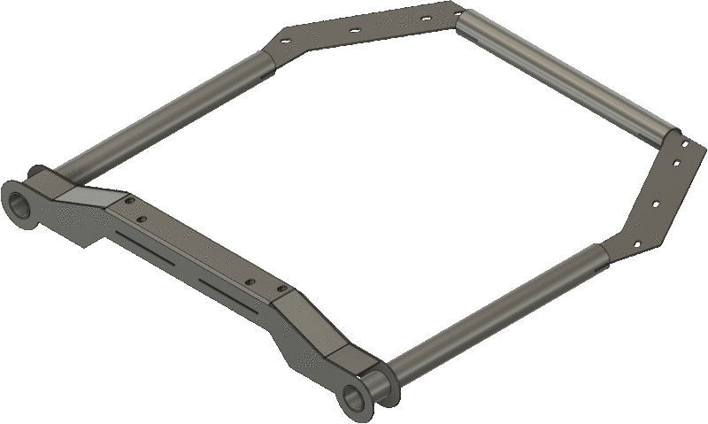

I have almost completely started from scratch. I was not liking the "Cheap" like method of building the engine cradle. At first it seemed ok, but things just bugged me about the way it looked.
So I been hard at work designing an almost completely 3D Designed Engine Swap Cradle. Its still in its early stages, but if things go right, I'll be able to manufacture with a pretty decent turn around time.
http://986forum.com/forums/uploads02...1527055706.gif
The inside is the same thickness as the stock Porsche mount so the original Studs or new ones can be used. Also fitted with Anti Crush Tubes inside.
http://986forum.com/forums/uploads02...1527056053.gif
