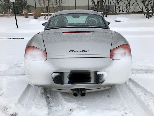

Daily driven, even in snowstorm today... With dedicated snow tires, no problems and it's fun!
Attachment 21356
