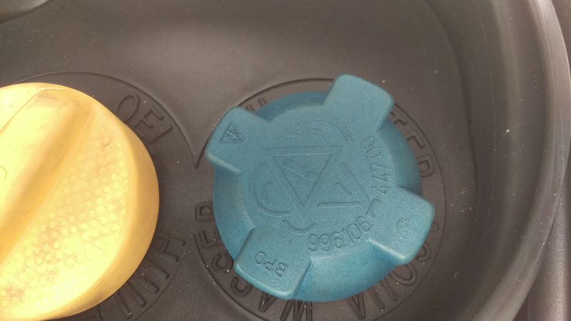

Ok I think it's just a hose, here are some pics of the cap and the dripping is coming from this smaller hose in this picture. The cap serial seems fine and no leakage in the trunk or bleed valve area.

rexcramer 05-29-2016 07:38 AM
You have the original cap. It ends in .00. The original was prone to issues. The latest version ends in .04.
996.106.447.04 is the latest rev.

right and I can replace that but the dripping is from that hose nothing near the cap or tank.
