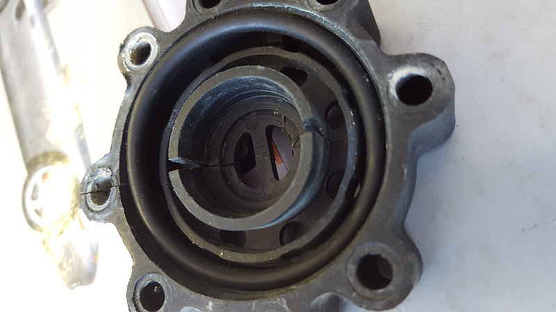

I changed out the AOS today and replaced the coolant releif valve which was completely shot!
http://986forum.com/forums/uploads02...1464312226.jpg
:eek:
This is only 2 years old!
