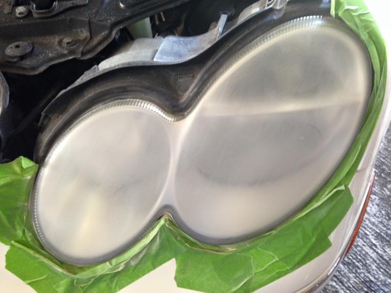

Here's my headlight on my Mercedes
http://986forum.com/forums/uploads02...1462428951.jpg
After two stages of sanding
http://986forum.com/forums/uploads02...1462428968.jpg
End results after buffing
http://986forum.com/forums/uploads02...1462428987.jpg
