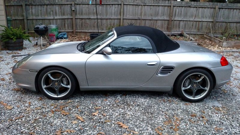

Here she is with new paint, not concours but dramatically better than before [emoji1] Wheels will be polished up this week
http://uploads.tapatalk-cdn.com/2016...4b8a00a04d.jpg
http://uploads.tapatalk-cdn.com/2016...f661ebc251.jpg
http://uploads.tapatalk-cdn.com/2016...6b292e5e47.jpg
