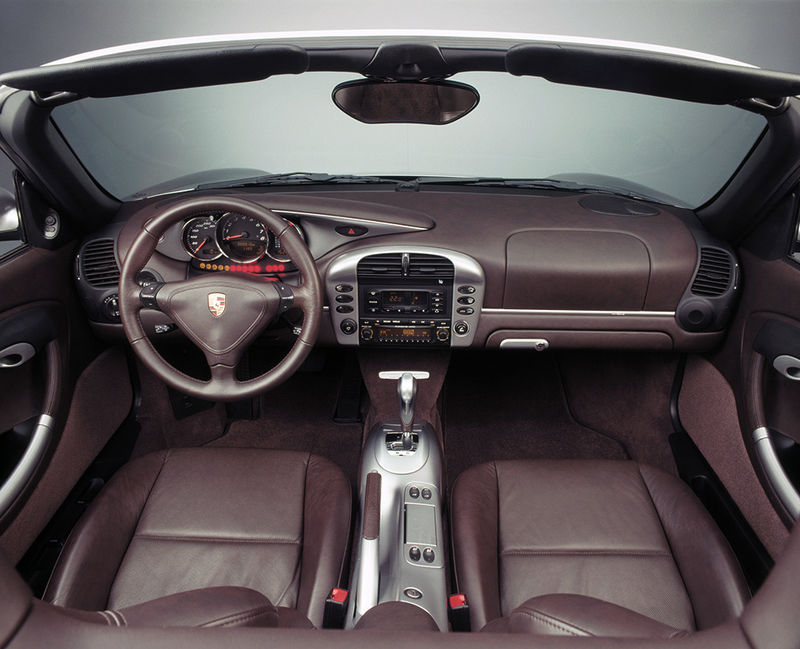

Smallblock454 04-21-2016 08:17 PM
Hi,
will not be easy to get an original seat from this edition car in gray. This is not the standard leather.
This is how it should look like in the color cocoa:
http://986forum.com/forums/uploads02...1461294709.jpg
Clear coat can shurely be fixed.
Hope the overall mechanical state is better than on the photos and you don't have to throw tons of money in.
Regards, Markus

Thanks for posting the interior shot Markus, it looks great in cocoa! I'm going to do my best to try and locate the gray seats, worst case scenario is reupholster. The mechanical state seems decent, I have tons of receipts of work maintenance work done over the past 8 years.
