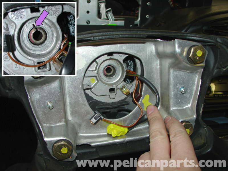

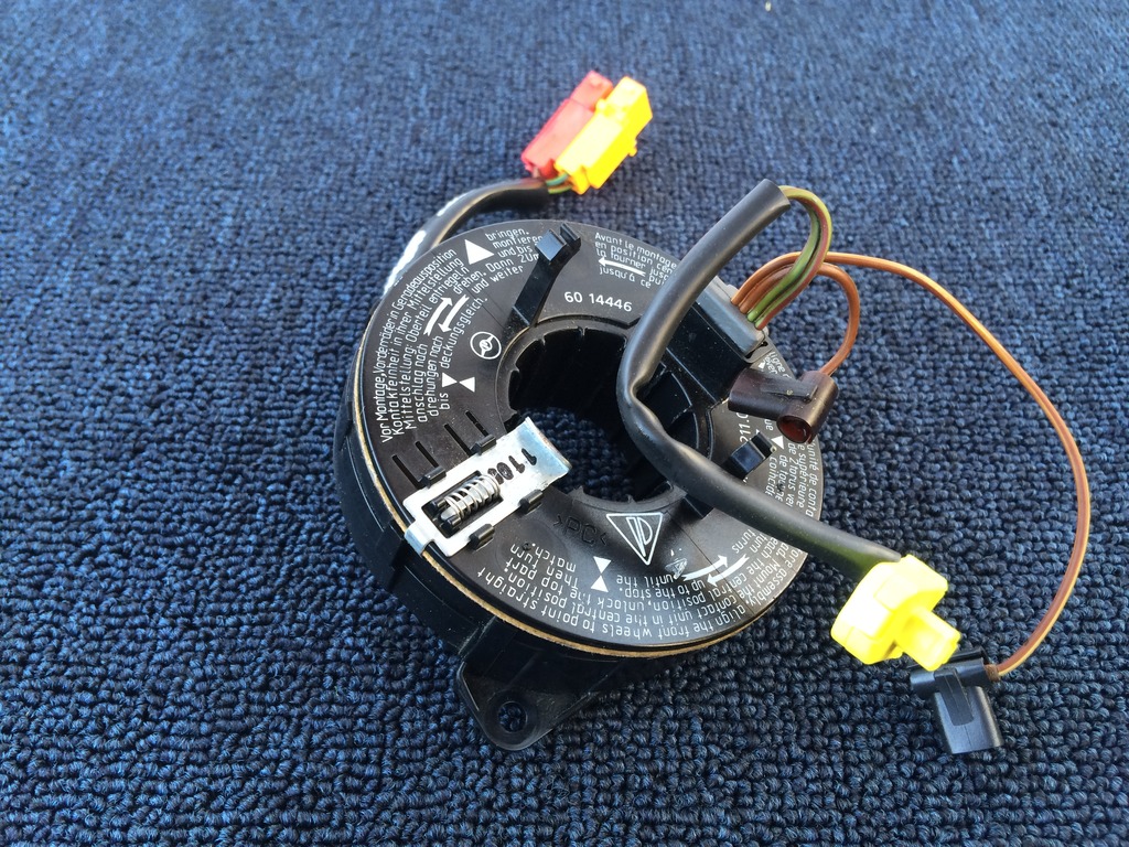

I broke the two forward facing plastic tabs on the clock spring. Any idea how I can fix this without buying a new clock spring? Is there a plastic piece I can buy at the hardware store and then glue it in place with some jb weld?
Also, since I am installing an aftermarket racing steering wheel with quick release I will no longer have the need for an airbag or horn. My question is what is the purpose of the clock spring and will the steering be fine without any tabs?
The tabs go into the two holes above and below the steering shaft.
Attachment 20089
I broke the two little tall plastic tabs in the below picture.
http://986forum.com/forums/uploads01...1455933859.jpg
Attachment 20088

Chuck W. 02-20-2016 07:29 AM
Yellow986S.... If you determine you do need to have the clockspring installed with your race wheel I have one that I'll give you. The plastic pieces are intact but the airbag plug is missing the plastic cover that goes over the female prongs. Since you're not using an airbag this should be good for you. The perfect is also available.
Here is a photo of it;
http://img.photobucket.com/albums/v2...pseqydhqts.jpg

I just figured out that the clockspring is needed to reset the turn signals. The piece at the bottom of the clockspring hits a tab that resets the turn signals. It appears that the clockspring is needed for the horn, airbag and turn signals.
http://img.photobucket.com/albums/v2...psbdw3fc42.jpg
