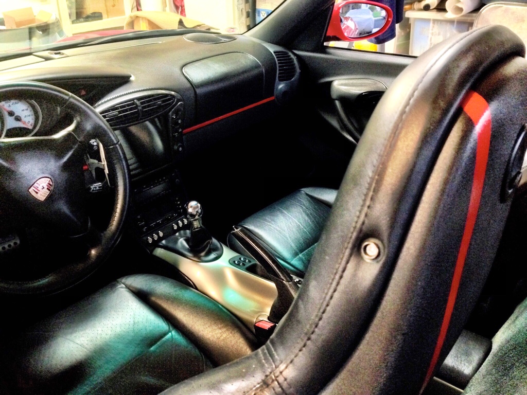

I moved AC controls to the bottom, radio one slot above it and iPad mini in the remaining football sized opening. Never had a problem selecting temp settings or fan functions.
Attachment 19612

Jamesp 08-08-2015 12:31 PM
Very nice interior epapp! What are the controls (or lights?) in the batwing?
