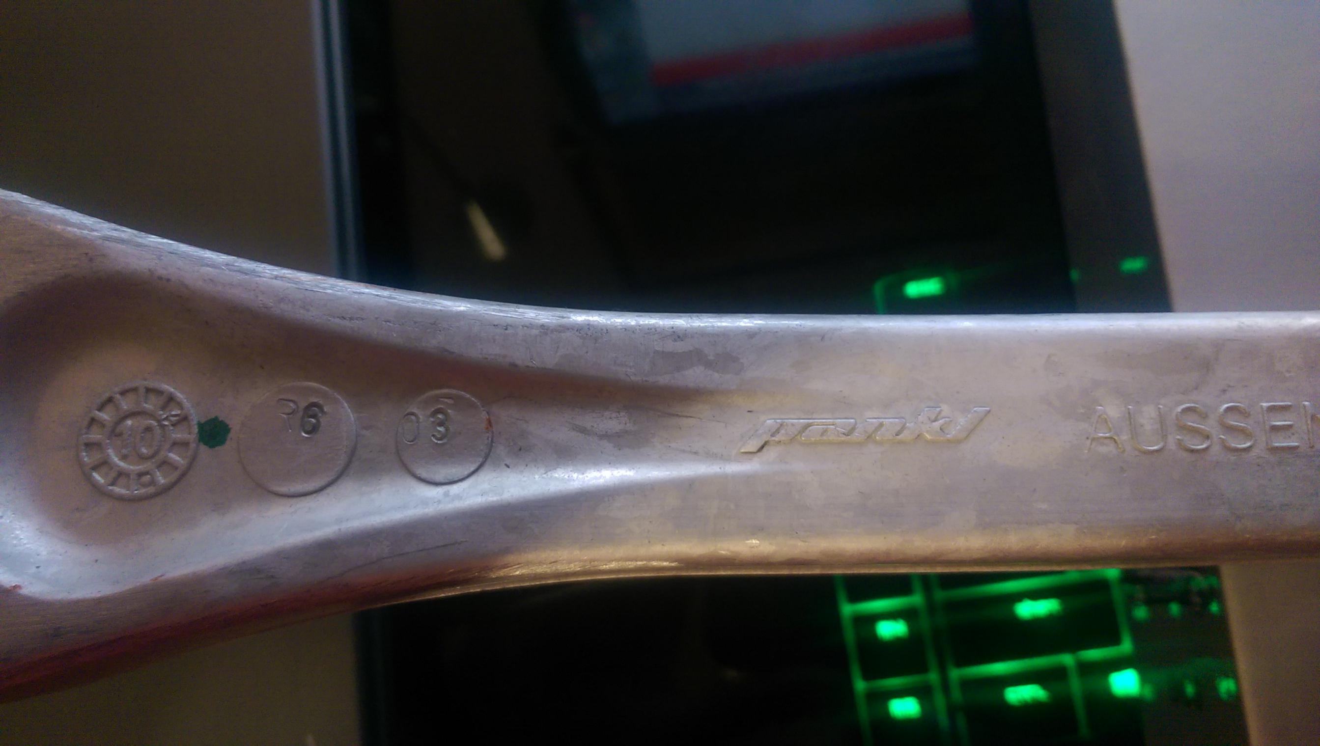

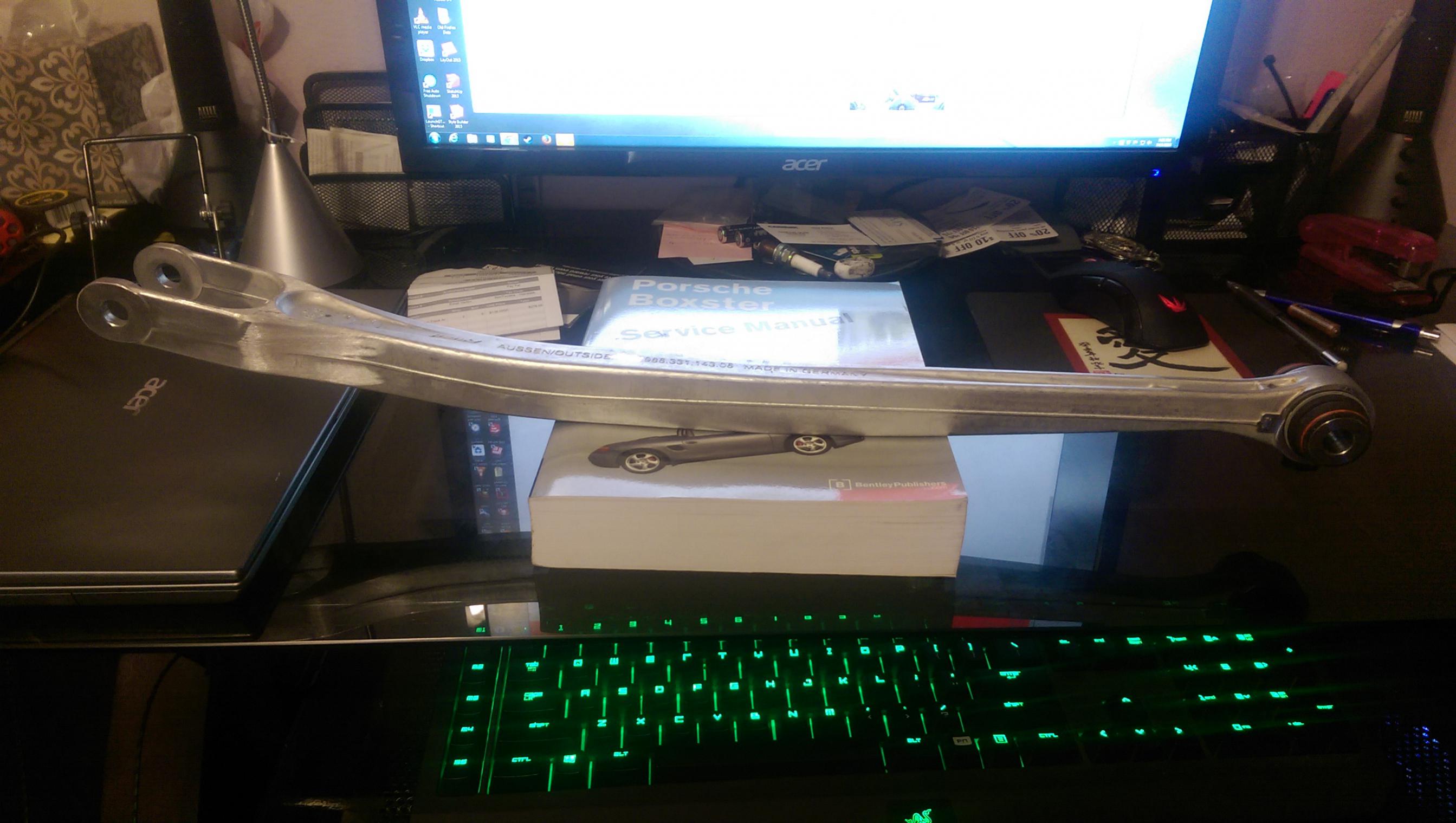

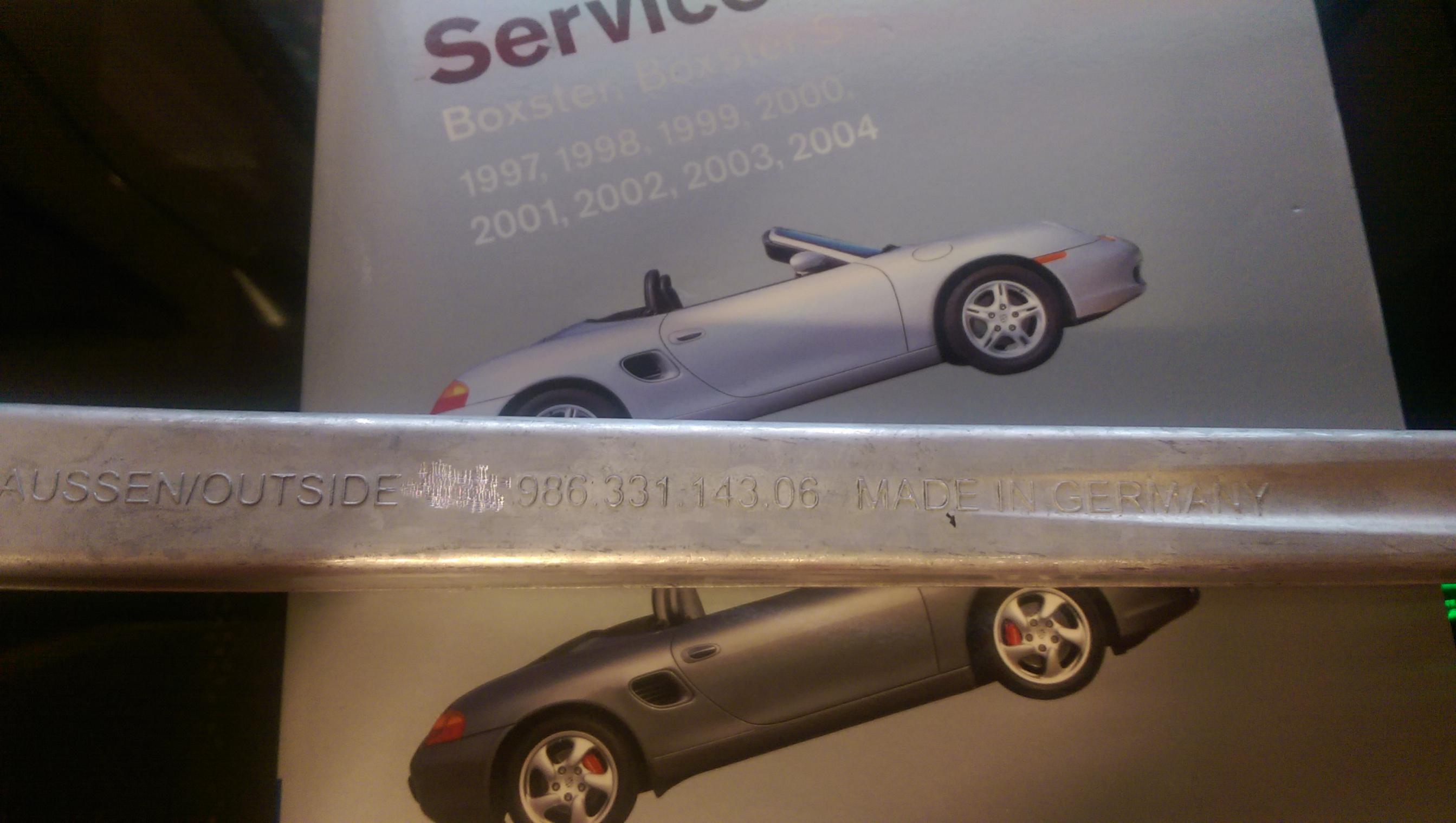

So the arms I ordered from Vertex Auto came today. The part number on the box (986 331 043 07) matches the OEM number, but the part number on the arm (986 331 143 06) doesn't. Also, it doesn't say TRW anywhere, and I can't find the part number on the arm on the Internet either.

So I checked the arms currently on my car (2001), and the part number is 986 331 143 04. It seems like these arms are the newer version, but I wonder why it's different from the Porsche part number?

In the area where yours is ground down next to the p/n there is a triangle shaped logo.

Thanks. That's the same number on the arms currently on my car, which I believe to be OEM. I think left and right are identical, so only one part/number. I'm curious why that area is ground down on mine. Does yours say Porsche or TRW anywhere at all?
spendy 07-19-2015 11:03 AM
I did not see a Porsche logo, only the triangle shaped one. I got some front TRW's recently, and I noticed they had a similar spot ground off also.

So I replaced both arms over the weekend. What a big difference. No more loud clunking noise, and the rear doesn't bounce that much over uneven surface anymore. I should've replace these a long time ago. As for the part number, the old ones on my car had part #986 331 143 04, with the triangle logo just like spendy said. My new arms from Vertex, supposedly TRW (they never got back to me after I emailed them asking about the different part numbers), don't have the triangle logo, and have part #986 331 143 06. I compared the new and old arms, and there's a difference in the beam profile, or curve. But still, the new arms fit exactly in place without any problem.
